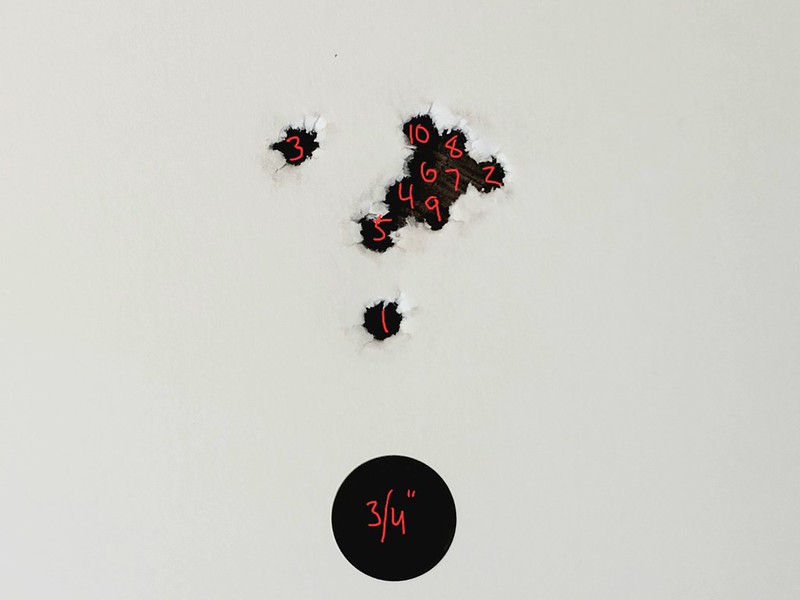

I have been shooting the hammer mono bullets out of a ruger american predator 6.5cm with good accuracy and when they came out with the little 85gr. bullet I hesitated at first. But then I got a sample pack of 15, loaded up a ladder using varget at 43, 43.5, 44, and 44.5 gr. for shots into an inch at 75 yds the first day, adjusted the scope and the next day put 3 rounds into a 1/2" at 100 yds, using 44.5gr varget lapua lrp brass, cci200 primers. primer was starting to flatten but not terribly, brass was fine. fps I think is up around 3200-3300, the chrono went on the blink after the first round of the ladder though. gonna use them on whitetails this year.

Yesterday in the ruger predator 22" barrel I got 3370-3390 over 4 shots with this 85 gr hh bullet in lapua lrp brass, 44 gr. Varget, cci200 lrp, primer was just a little flat. got 1" group at 100 yds , the 44.5 gr varget load shot better so going back to that. used a new magnetospeed sporter chrono. wrapped the end 6" of barrel with cloth friction tape and the magnetospeed stayed put.

I only tested a ladder series to find max pressure, from 40.0gr to 41.8gr in 0.2gr increments. 41.8gr was my max at 3470 fps. I will test for accuracy next around 41.0gr and 3400 fps
that 85hh is a sweet shooting bullet. .003 or so neck tension and a lee fcd crimp die can do wonders for even better accuracy from the hammer bullets. just wanted to throw that out there.
Charlie, I have done both but with these 85gr hh bullets I am seating kinda deep and seating in the first groove. hammer bullets can usually take alot of jump, I know mine is over .150 maybe more and it shoots these lights out. started with a light crimp and a 1" group and adjusted the crimp a little heavier maybe another 1/8 turn and it went to 1/2" group 100 yds. If you try to get anywhere close to the lands with the 85hh there wont be enough bullet seated in the neck imo. kip
seating and crimping in the first groove with the 85 for my gun. last season I hunted with the117sh .264 bullet and seated it out further and crimped on top of a pdr rib or as you say full diameter but that bullets design and length allowed me to do whatever I wanted as the shank section is so long on the shock hammers. there are some very knowledgable hammer shooters that always crimp in a groove with the lee fcd die. you do either want it dead center of the groove or right on top of a rib, if you end up on a slope the OAL can move when you crimp. thats what they say anyway. kip
