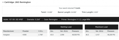

based on this for the 260 Rem, and knowing that the 6.5 CM is less capacity (~ 55 vs 53.8 H2o) looks like max is about 43-44gr which did match up with what I got from GRT. As always start low and work up watching for pressure.
Shurfire's data for 243 win was spot on, Hodgdon shows max for that with a 107 at 34.8gr. amazing how just the increase in bore size lowers pressure so much. I wouldn't have expected the volume change to be so much but clearly it is.
