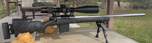

This is my favorite stock of theirs. This stock, bottom metal and magazine was made by H-S. A long action version of it was the M-24, a quite renown sniper rifle.
I have a .338 LM Israeli-commissioned and certificated complete rifle, that they literally made every bit of, according to accompanying paperwork, action, barrel, stock, trigger, brake, DBM, screws.
Coincidentally, this action and scope below were also by companies that quietly produced under contract back in time, Stiller and US Optics.
Don’t take this out of context, - that is truly one impressive butt, if you had to pick just one to get behind to save your life, and these stocks are 100% all business.
