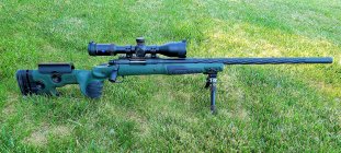

Looking for a new stock for my Tikka CTR, and I came across these GRS Bifrost stocks. They look very appealing and versatile, which is what I want. Anyone out there have any experience with them?
I want to use this gun for PRS matches, and also to hunt with on occasion.
I have never heard of them. I have a couple Tikkas but don't recall seeing any in PRS/NRL events. I am sure there are a few. The stock looks legit and the price is decent. On a Tikka, I'd be more interested in the bedding the stock offers though. You need something solid in that department for a 200+ round multi-day match. A 10+ round mag or two is crucial. Are those available for the Tikkas?

This stock uses the same Tikka mags, and I have 4 - 10round mags. Should be good there.
I run a Tikka in PRS/NRL. No issues. Main downside to the GRS would be the cheek piece isn't ambi. On occasion you have a stage that requires you to shoot weak side.
My hunting/tactical rifle is a T3 in a Manners with CDI bottom metal that takes AI mags. So, that is available.
One thing to know is the GRS stocks I’ve handled all have an angled hand placement for the trigger hand. It’s very comfortable to me but if you’re not aware of it, it can be confusing or disorienting.

I have several GRS stocks, super adjustable AND no need to bed them. Torque to their recommended setting and ignore it. VERY comfy stocks that fit your hand correctly.
