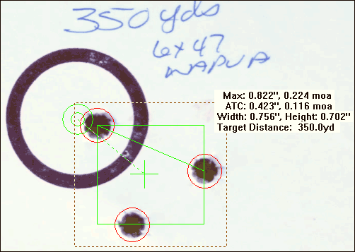

One thing I can say -- we have witnessed almost complete novices produce sub-half-MOA groups. These were young people, with almost no gun experience, who were shooting full-boogie benchrest guns. Unlike most guys at the range, these teens LISTENED to instructions, did what they were told, and shot really well.
READ THIS: http://bulletin.accurateshooter.com/2018/06/novice-shooters-deserve-accurate-rifles-too/
This group was shot by a young lady, with almost no shooting experience (story link above):
Three shots, quarter-MOA at 350 yards:
That is quite some shooting by that young lady ,great article . You nailed it when you mentioned "Listened" , that is a major part of this sport .Many folks ask questions,but not so many listen to the answers .
