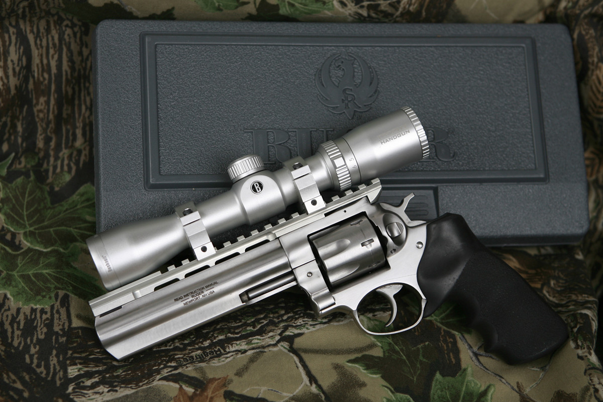

Gp100 327 fed????
I had bought a sp101 in 327, but i found out way late about the gp100 in 327 and never bought one. Then this covid hit, doh. Anyone think ruger might reintroduce a gp100 in 327?
Figured it would be a pussycat in a 6" revolver
The SP 101 is perfectly proportioned for a 6-shot .327 Fed. Is one extra shot really worth the bulkier dimensions and weight with a GP 100? Guess it’s up to you.

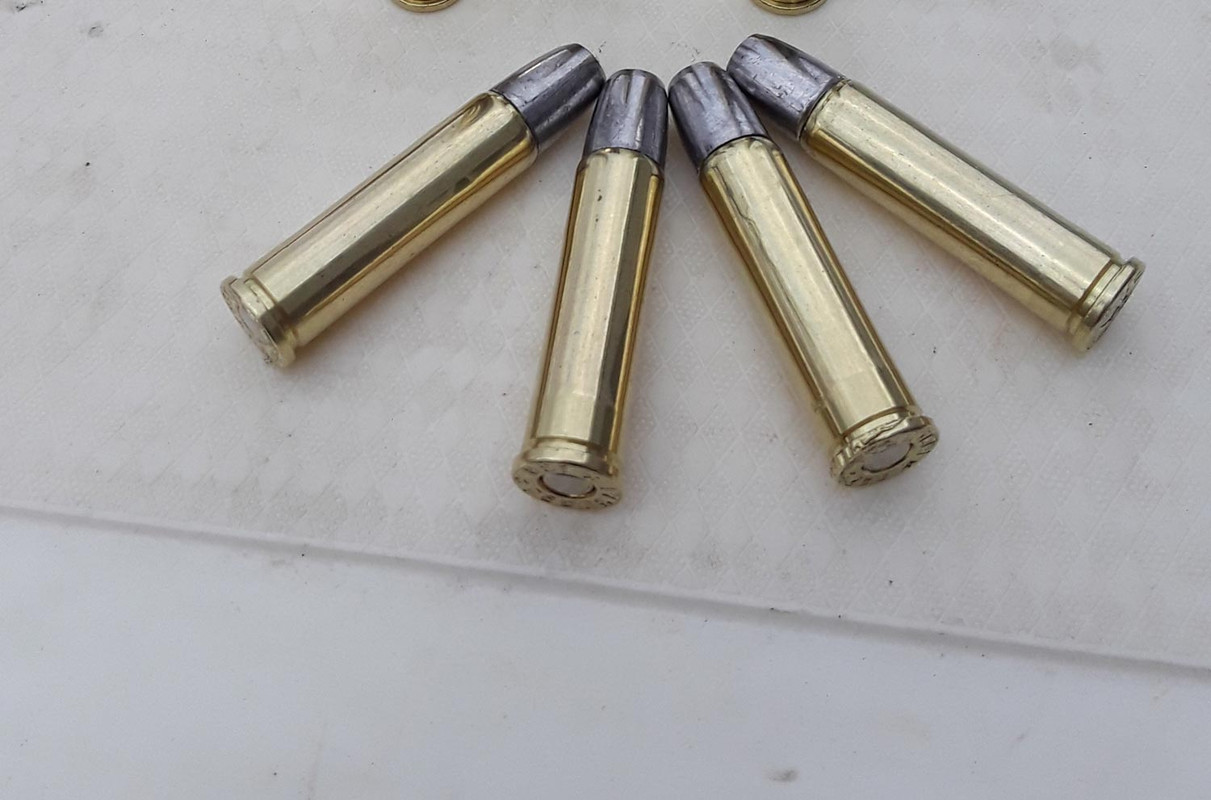

I was putting some reloading stuff away today and i ran across these.
I forgot they even made 60s
The tiniest lil boxes of bullets . Lol
