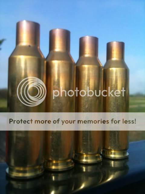

Here is some of the brass I annealed today, it looks like if I just pulled it out of a brand new Lapua box!
