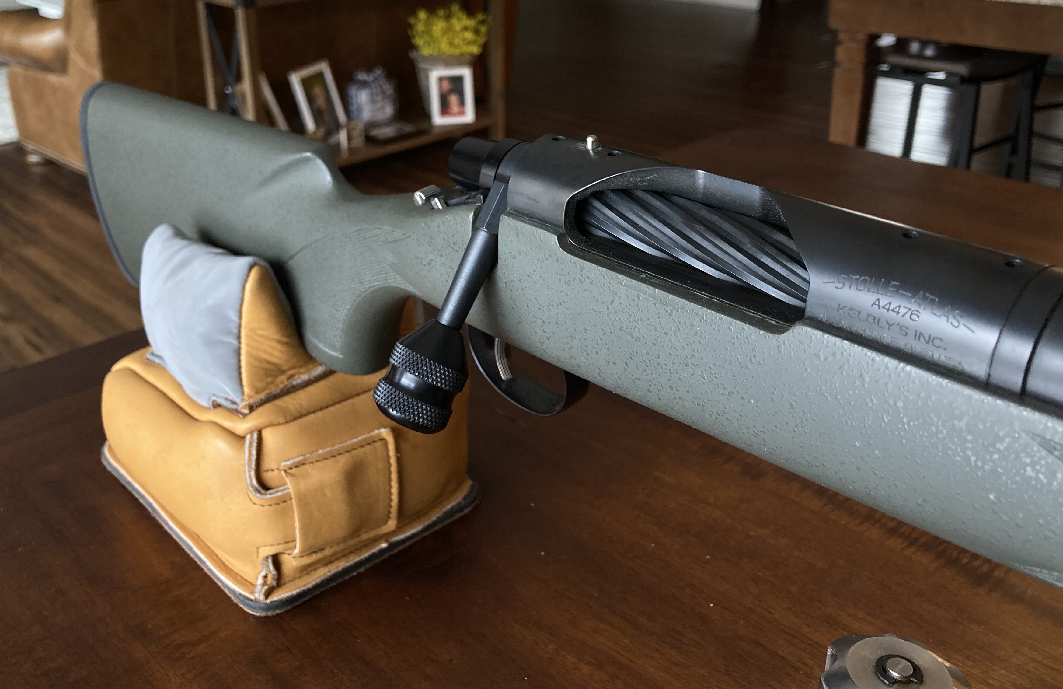

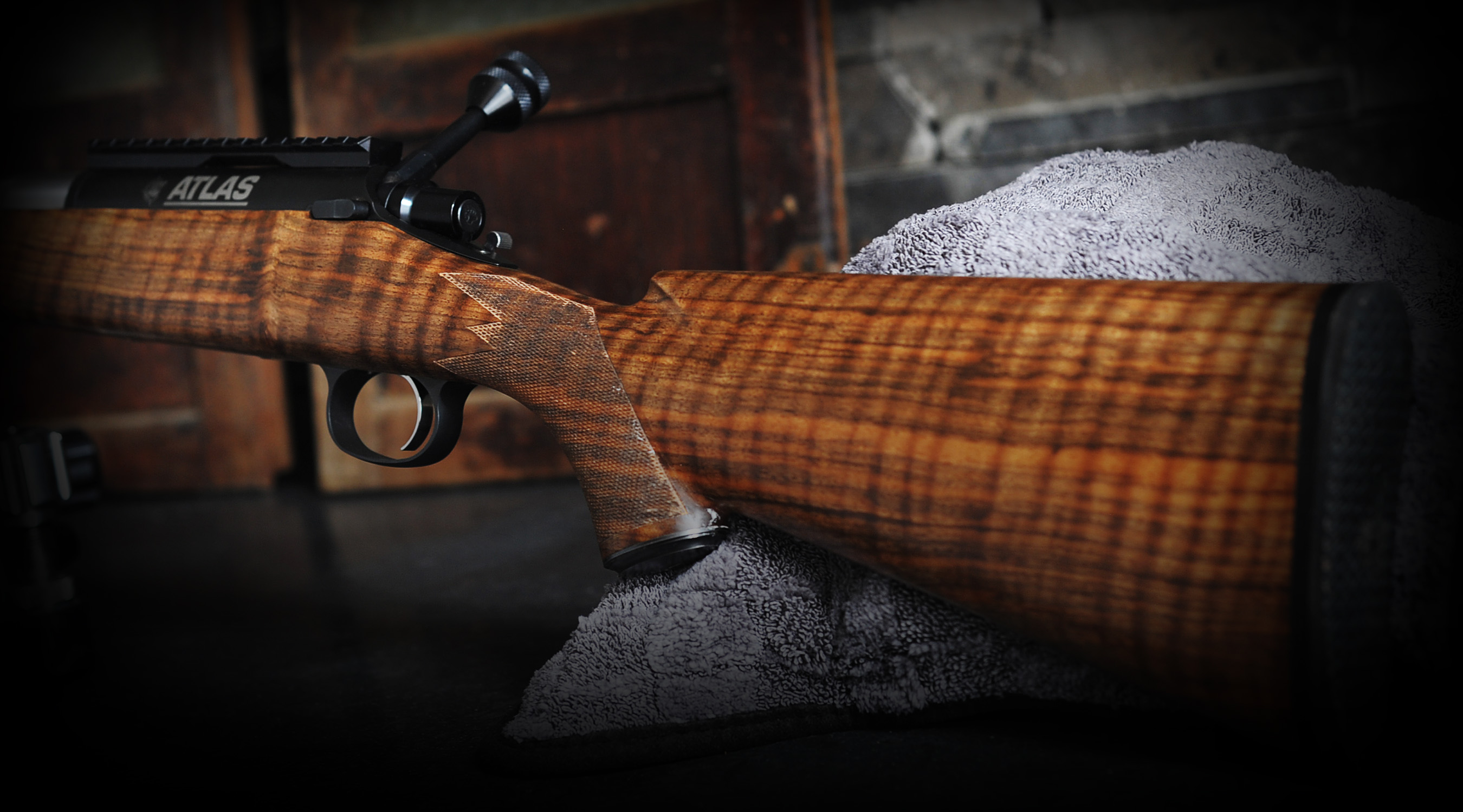

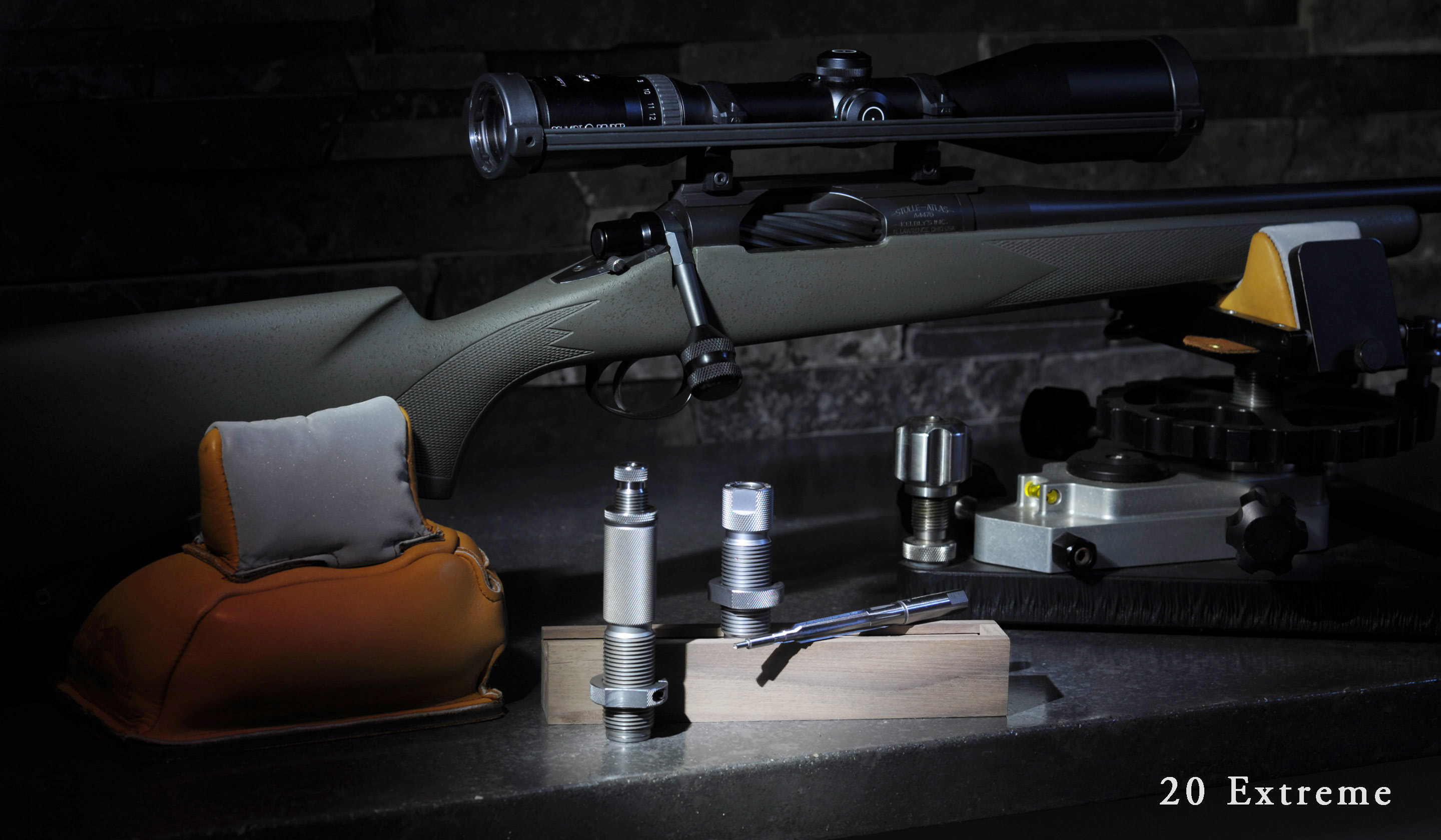

I had two custom 20Extreme rifles built which took a very long time and a lot of patience (I even forgot about them at times).
I love this cartridge so much that I want a 3rd 20Extreme, however, I don't want that wait time.
Can anyone recommend a nice donor rifle for the 20Extreme? The 20Xtreme is a 222.
I've heard some good things on the Sako A1 being a good candidate.
Thank you!!

What a gorgeous stock you have on that wood stocked rifle. The little Sako actions are a personal favorite. I don’t know what a 20 extreme is, what bullet or mag length your dealing with but if the OAL will work in a Sako with the bullet you desire to use it’s a great option.
I built my 20-222 on a Tikka action, ordered mags that have extra OAL abilities and I’ve been happy, also like the plain Jane older Remington actions. The little CZ 527 is a neat action. Lots of good choices, I’m sure others will chime in with their own preferences.

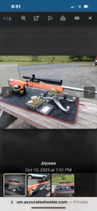

I shoot the. 20-222 in a rem 788 and a sako l461. Pretty hard to beat the little sako. Would probably work well in any of em.
