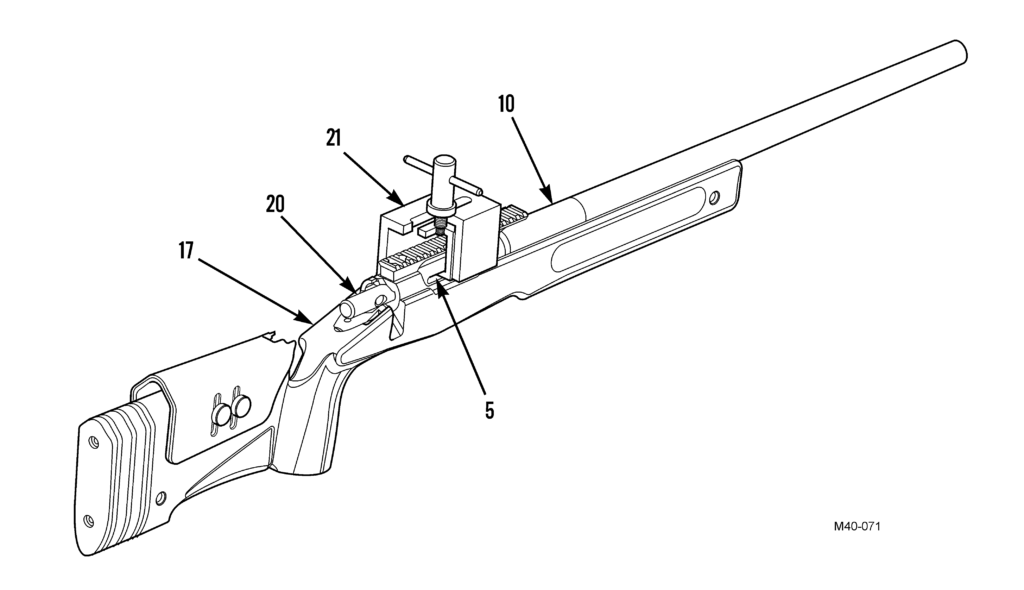

^^^^ The lifters in that link are so over kill as to be a waste of time and money. I made one from a piece of oak scraps I had after building something for someone. Make the bridge out some type of hard wood and use a C clamp, they all pop right out and the doesn't scar the stock.
I made the one out of the referenced m40 guide. Cut from a solid aluminum block. It was a fancy weekend project. It’s very handy
