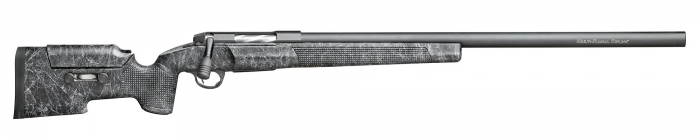

Hello from France to all the community of American shooters here on this forum ;).
I am going to start an adventure with this new caliber : the 284 Shehane. I have already read a lot of things on this forum about this subject, but I didn't dare to pollute other people's topics.
I ordered an Italian Sabatti Tactical EVO rifle, because there is no other brand in Europe that offers this caliber.
It has a 28" long original barrel with an external diameter of 1.10". The rifling system is the MMR.
I ordered my components, Vihtavuori N160 powder, Lapua Scenar L 180 Grain bullets and Lapua 284 Winchester cases. The primers will be Federal GM210M.
I would have liked to have your opinion for the Fire-Forming of the cases. I was thinking of using Vihtavuori N150 powder with Lapua Scenar L 150 Grain warheads, and not shooting directly full load and with 180 Grain bullets.
Let me know if I'm doing it right, or if you have any other good advice for me. I know I didn't buy a Match grade gun, but I don't have an unlimited budget.

Hello friends from across the Atlantic. A quick review of my first test session with this Sabatti Tactical EVO in 284 Shehane.
I had prepared 6 cartridges, with a 0.023" rifling removal, new LAPUA 284 WIN case, 53 Grain of N160, FED210M primers and Lapua Scenar 180 Grain bullets.
Average velocity measured with Labradar = 832 m/s (2730 fps).
I had 2 big overpressures, with a primer tear off on one round, and on the other a big ejector mark.
Target accuracy at 100 yards was awful = 2" of grouping (2 MOA)
My cases are new, I thought I read that some shoot with a normal load from the Fireforming, but I have the impression that it will have to review the load of powder down.
Of course my gun is being broken in, so I clean it between each shot for at least 20 rounds.
I am quite disappointed with my day, tomorrow I will analyze this and redo a measurement of the rifling.
