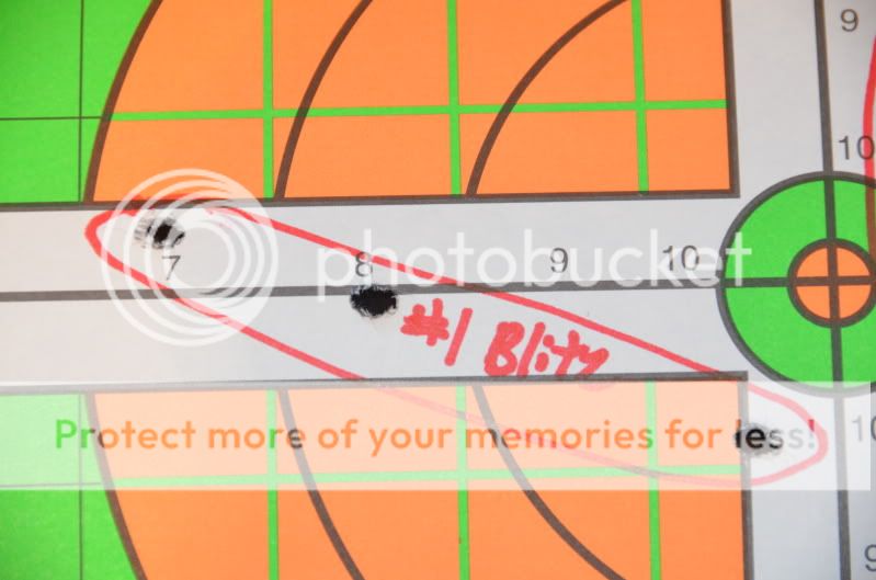

I'm reloading .204 Ruger using 40 grain SBKs and getting some very extreme fliers. When using factory ammo or handloads with different bullets (i.e. vmax) I don't get the same effect. The gun is a strong 1 MOA (or slightly under) shooter but when I use the SBKs I get some very strange results.
I'll shoot a 5 shot group and 3-4/5 will all be within 1 MOA. But one or two will be 12+ inches away (100yds)?!?! No rhyme or reason in terms of how hot or clean the barrel is or the shot number in the group. I've never encountered this and for the life of me, can't trace down the root cause.

Are the holes in the paper oblong, I.e. going through the paper sideways? What type of rifle is it? Probably the scope as mentioned above. If that's not it, clean and bore scope.

My Remington 700 SPS Varmint 204 couldn't handle the 39 SBK's....they shot all over the place and keyholed.....some shots looked normal but most were oblong. But my Encore Pro hunter 204 barrel liked them just fine. What brand of rifle are you shooting them from and what's the twist? Both mine are 12 twists but the 28" Thompson barrel liked them and the Remington didn't.
Its a Ruger M77. 1/12 twist. And yeah, after going back and looking at the target, the ones that flew way off look slightly oblong. There's only a couple...most didn't even hit paper.
So I guess it's the bullet and my rifle doesn't like them? I'm just amazed that the 40gr Vmax never do this yet this bullet does. My gun loves the 40gr Vmax. It handles the 32gr Vmax well but not as tight at the 40gr Vmax.
probably have issues stabilizing that bullet. Even though those bullets are the small weight, the V-max may have more bearing surface.

SBK's have a very thin jacket --- if you have even the slightest carbon ring accuracy will go to hell, V-max may shoot just fine. Had a cooper barrel go south at about 700-800 would shoot v-max but not the SBK's. Jacket seems so thin just doesn't take much to mess with them

40 gr may be on the border of the proper twist for the 40 SBK. Shoot the ones that work and forget the ones that don't work. Like others said stability is somewhat bearing length dependent. There may be a difference in bearing length in 40 gr brands. Try the 35 gr. they like the 12 twist.

Sierra does a 32 and a 39 grain BlitzKing in .20 caliber but nothing in a 40 grain. The 39 grain SBK has become somewhat famous for being stabilized by and generally shootin’ fine in most factory 1 in 12 twist 204 Ruger barrels where nobody else’s 40 grain stuff will do so.

You are correct, these are 39gr (not 40gr as I stated). I misspoke. And your assessment of the 39gr SBK is pretty well in line with everything I've heard and read. That's why I picked some up and why I'm so surprised with my experience. I've read very few bad reviews on them and considering how well the 40gr vmax shoots, got to believe there is something wrong with this particular batch (as others have stated).
