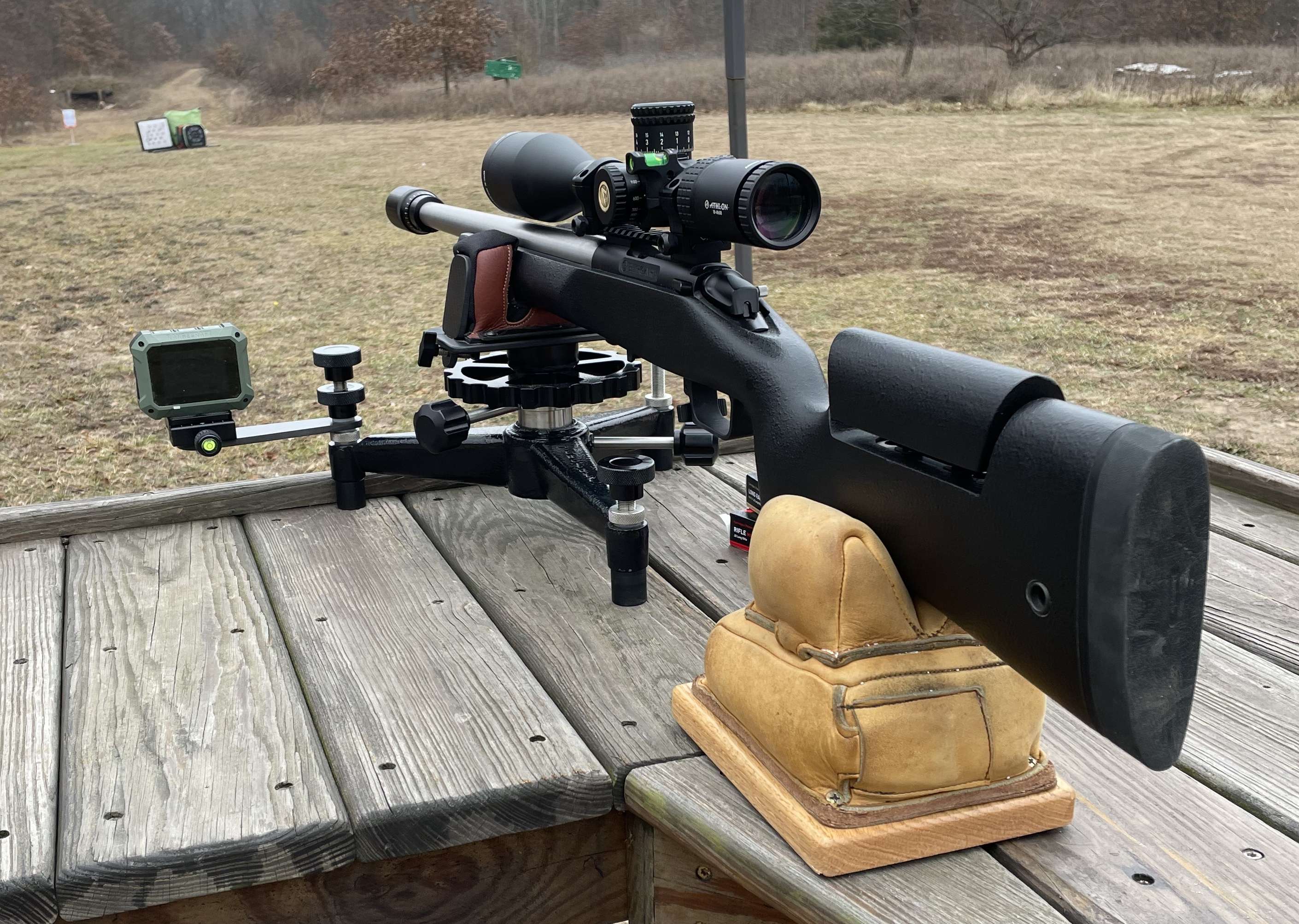

I wanted something more stable for my Athlon. Came up with this simple swing arm made from some carbon fiber sheet and a basic Arca camera mount.
I also installed another Arca receiver on the factory supplied tripod for use when not using the heavy rest.
Plundered in some old junk drawers in the tool room today and found a nice piece of chrome plated metal so I mounted my Garmin to the front rest as well. Maybe not needed but I isolated it from the metal with a thick rubber washer just in case vibrations were a factor. Gonna try this configuration first and see if it works without re-adjusting it. It rotates with the elevation knob without hitting any part of the rest top.
