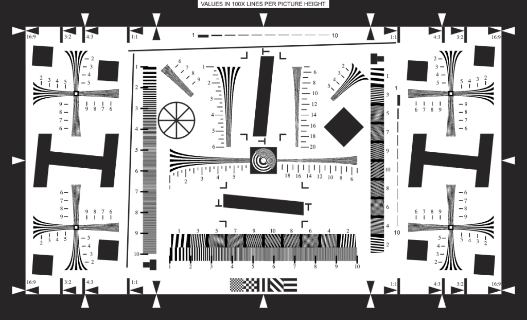

I have a hard time comparing optics by looking. I have been better able to quantify the differance using an optical test pattern.
