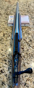

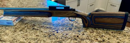

I have a 722 I turned into a single shot bench rifle.
- Custom fit aftermarket one piece bolt with PPC face and Mini-16 extractor
- Bottom safety Jewell trigger
- 3” Protektor BR stock with full receiver Marine Tex bedding
- Shilen Select ratchet barrel chambered in 243 LBC Turbo-40. Has a .269” neck with 1 in 8” twist
Action is timed to the trigger and locks up tighter than Fort Knox when in battery. Scope rail is aligned and bedded to the receiver as well.
I have brass, dies, reamer so the rifle is ready to go. Just need to put a scope on it.
Barrel only has 50 rounds on it from fire forming brass so it’s not even broke in yet. Fireforming loads are extremely accurate.
Asking $1300 shipped for the rifle. Can discuss brass, dies, and reamer at extra cost to the buyer. Thanks so much.
