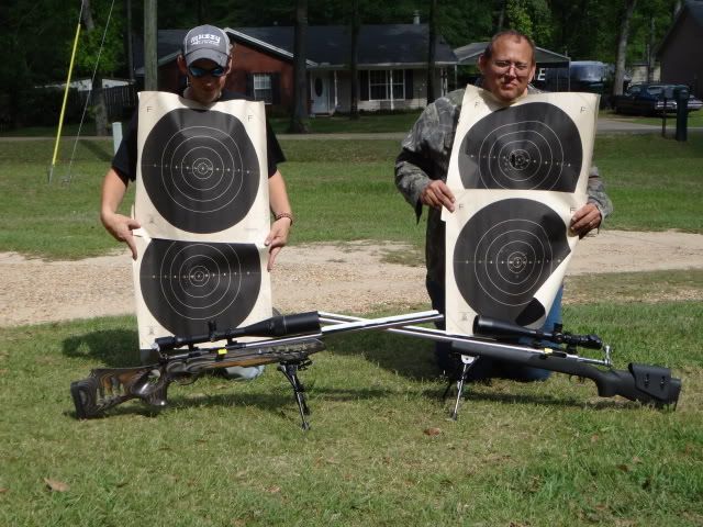

the one on the right is my mod.12 lrpv with a 30 shilen full bore barrel sightron 10x50x60 lrirmoa2 scope and HS Precision stock (the stock what comes with it from the factory) i weighted it with a electronic fish scale and it says 16.7 lbs as it sits with a harris bipod.
