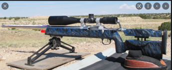

Will this work too?
If you can find a reasonably-priced Remy 700, it can certainly work as an F-TR rifle. They are amenable to being trued/blueprinted by a gunsmith and have many options available such as aftermarket stocks and triggers. However, I have to agree with the others that even for me, that stock would be a deal-breaker. In the image below, I circled one of the major problem areas in red. Notice the highly angled toe (i.e. the underside/bottom of the buttstock), as well as the butthook (cutout). These are not desirable for tracking well in an "eared" rear bag, or even a rear bean bag.
I am one of the few remaining F-TR shooters, perhaps on the entire planet, that still uses a pre-loaded traditional bipod and rear bean bag, as opposed to a ski-type bipod and an eared rear bag. With a traditional bipod and squeezable bean bag, the idea is that you push forward into the rifle buttstock to put pressure on the bipod legs/feet, thus minimizing their movement and stabilizing the rifle setup. Squeezing the rear bean bag then allows for elevation adjustment. With a ski-type bipod, the whole idea is to let the feet (skis) track straight back freely across a piece of carpet during the recoil impulse. An eared rear bag is used to facilitate this movement. To accomplish this with such a ski-type bipod setup, you want a relatively long section of the toe to be straight and flat, with only a very minimal angle to it for minor elevation adjustment.
Although it is possible I might be able to use the stock pictured above and get away with it using my rear bean bag setup, notice how short the toe is at the rear due to the butthook (cutout), in addition to being highly angled. Using a stock like that effectively and consistently with a ski-type bipod would be exceedingly difficult.
