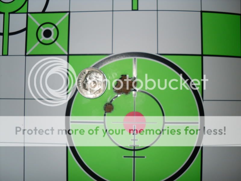

Here is a picture of a 6 shot group at 100. The one that fell out of the group was due to a flinch so I fired another just to make sure. The group posted is an average group for the rifle
I did check everything..that was my first thought too. I shot it at 100 and did well. Shot it at 200 and did horrible. Went back to 100 to see if it was the gun but it shot well at 100 again
Did my ugly green target give me away?

you did not post any of the bad targets so it is hard to draw a conclusion without seeing those. However 100yd. groups are not always conclusive for picking a load for down range shooting. If your groups where consistant at 200 by that i mean same angle from right to left or the other way around . You know the barrel is good I would suspect the bedding to be the the problem . This does not mean that you have to re-bed.
Next trip to the range work with torque on the the action screws . Remember if it changes anything good or bad it can be fixed . If you would like a more detailed explanation feel free to PM me . The Rifler

I wouldn't think it would be seating depth. Have you ever shot it past 200? I'm guessing a bedding problem that's just not as evident at 100. Your 100 yard target was dia lower left to upper right even thou you had 5 clustered right on top of each other.
