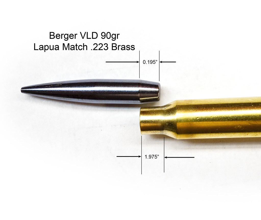

Nice work, but I'm in the middle of making some match ammo using the .223 Berger 90gr VLDs in a barrel made with the same reamer you use.
Something didn't look right to me. So I made a couple of measurements and took a snapshot.
Seating depth photo
Notice that the boat tail of the VLD 90 is nearly as long as the .223 case neck which doesn't match at all with your photo. You can see that if the base of the boat tail is even with the neck/shoulder junction, there is insufficient bullet bearing surface in the neck; i.e. not enough to grip the bullet properly.
I wonder if the "bottom line" you refer to is not really the neck/shoulder junction but rather the junction between the shoulder and the case body? That would make sense.
What say you?
EDIT: I have an obvious typo on the neck length. It is actually 0.1975", but I'm too lazy to redo the photo.
Seating depth photo
I wonder if the "bottom line" you refer to is not the neck/shoulder junction but rather than junction between the shoulder and the case body? That would make sense.
What say you?
Yes, that makes more sense. Sorry, typo on my side. Thanks for pointing it out.
