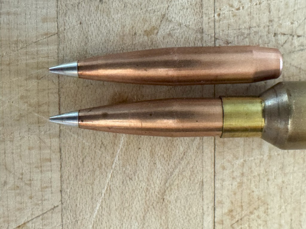

This is what 0.250" looks like with the 190 ATip in a 7/300PRC case.
This is just touching the lands which is not a setting I'd ever use.
