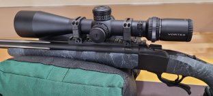

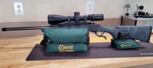

The teenagers are new for me. I chose the FB due to it being pretty straight forward with a ton of fps. I wasn't sure about if the reloading would be a problem due to being itty-bitty. Time will tell? I built a Ruger No.1 with a Lilja 24-inch, MTU, 9t. Hopefully it will give me the accuracy I want with the 25 grain Hornady Vmax.

Mike, that’s a sweet looking rifle, hope it shoots great for you! IMR 8208 is my go to powder for the 17FB.
