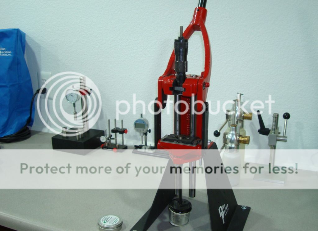

I have one am very happy with it. Previous presses were a Rockchucker and a Redding Ultra-Mag.
I added a Dillon Strong Mount to mine.
Hoser
Hoser,
I see that you have the Sinclair bullet comparator in the background, but with a different indicator than mine. Is that an upgrade?
Thanks,
Joe
