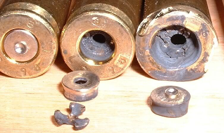

This is Lake City [LC] 308 brass I necked down to 243.
I did not turn the necks.
They are all the same load.
Some necks pinch the bullets more than others.
Clark
I have a bigger question. Why are there two of the blown cases??? After the first one, did you not realize something was wrong? Bad wrong! That loud noise you heard was your rifle screaming, "STOP! Don't do that again!"
And, if it was really a situation where the neck was "pinching" the bullet enough to raise pressure to a destructive level, did you not notice difficulty in chambering?
There are a lot of things that do not add up.
Ray
