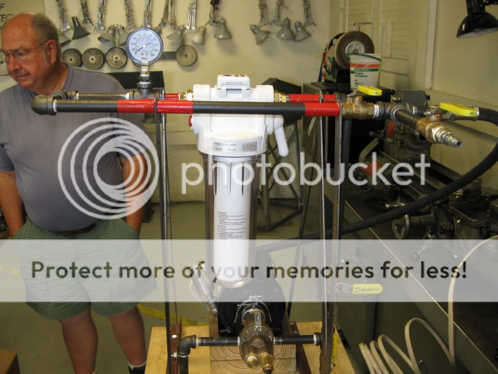

Just a followup there are a few seats still left in the June 2010, High Presure flush System High Speed Chambering, NRA Short course being held at TSJC. The students will build a high presure flush system for the school and use it to chamber their own barrel(s). If you are intererested please feel free to call.

We had a great class and everyone said they learned a lot and had a good time. Speedy Gonzales, Keith Gibson, Dave Noland, and Donna Haddow could not have been better host and hostest. I would like to express a heart felt thanks to the students and host at TSJC.
Nat Lambeth
High Pressure Flush System made at TSJC
Have you ever set one up for a CNC turning center?
My Haas SL20 has a 4ft long feed tube behind the chuck 2" ID, makes it tough to flush.
1/2" pvc with a rubber coupling at the muzzle, run through the a bushing at the door with a swivel on the end, tubing connects directly to pump.
