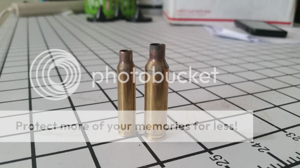

I got rev 2.3. It comes with a few different sized ferrite halves so you can adjust it to the size of your brass. I installed the one that would be wide enough so I can get the neck between the coils. I took a bunch of brass that was either split or "throw away" brass and tested the unit out. The unit is very simply. Set the time, put the brass between the coils and press the start button.
I had 750F degree Tempilaq so I brushed on a sliver onto the neck/shoulder.
I started with .223 and set it at 1.4 seconds. Too hot! Thing turned slight orange on the neck, but I noticed with about 0.3 seconds left, that was when the tempilaq burned off. I set the time to 1.1 seconds and repeated the process. The tempilaq burned off with no orange glow. I messed around a little bit more with a couple other pieces of brass and determined that 1.1 seconds was the right temp for the .223 brass I had.

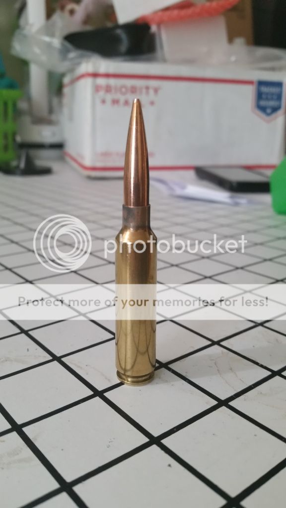

Went to 6.5 creedmoor hornady brass. I had a few pieces of brass with split necks or loose primer pockets and so I used that to do my testing. Tempilaq goes right on and set it at around 2.3 seconds. Turned it on and again too hot! The tempilaq burned off around 1.8'ish seconds so I set it to 1.8 seconds. Not quite a full burn off, so I adjusted to 1.9 seconds. This did the trick.
Moved up to a larger cartridge, Lapua 6.5x284 necked up to 284. I had two pieces of brass to mess around with. Set it at 2.5 seconds and the Tempilaq did not burn off at all. As I waited for that piece of brass to cool down, I took the other one and this time, I put the time to 4.5 seconds and I would try to stop it when I saw the tempilaq burn off. You can pause the process by pressing the start button again. There is also a footswitch version, which I did not get. So, I start it and noticed the tempilaq starting to burn off around 3.8-3.9 seconds. Wow! that took a while. I can only attribute it to the lapua brass and with the brass being a little thicker than most other brass. I suspect LC brass would be the same. The other piece cooled down and I tried 3.8 seconds. That worked well, burning off the tempilaq on the neck and just below the neck/shoulder junction. I then took two pieces of brass I was ready to put through the sizing die. I put both through the Annie. let is cool down, and then FL resized it. Did all my other prep stuff and then dumped some powder, put a 180gr hybrid on top of it (this is a 284 Shehane by the way) and then seated the round. I was using a .311 bushing, which with these two pieces of brass, gave about 2 thou neck tension. As I seated the round, I noticed very good neck tension. I will be shooting these tomorrow for fun.
I tried a larger ferrite halves and noticed it took a little bit longer to get the brass heated to 750F. I can only suspect that the tighter the halves to your brass (and thus, the closer the coils), the better and faster the process. I still had clearance between the two halves. I was only annealing the neck and a very small portion of the shoulder. I did see some blueing and darkening of the brass after the annealing process with the Annie, but most of it stayed above the body/shoulder junction. See pictures. I am not sure if this is a good thing or if the shoulder should also get annealed as this area is resized every time if you are FL resizing. When using the larger opening halves to get a piece of brass between the coils such that the majority of the shoulder was between the coils as well, you can get it to anneal down a little bit more, but you have to watch for over annealing. I tried this on a 6.5 creedmoor brass and I could tell the neck area was getting to the point of over annealing shortly after the tempilaq burned off in the shoulder area.

I used 750 tempilaq all the way around on the INSIDE of the neck and the tempilaq does burn off around the brass. With the larger caliber rounds, I was doing a slight 1/4-1/2 turn. I do not think this is really needed though as I saw no difference between leaving it there and spinning it a 1/4-1/2 turn. I also put the tempilaq on the shoulder and it does burn off mostly either right below the shoulder or mid-way through the shoulder. A lot of this is also dependent on how you set up the machine. You can put just the neck between the ferrite halves or you can put the front top part of the case. Simply do a mix and match of the different sized ferrite halves. This is the bit of trial and error you have to do. I used throw away brass (of the same brand/mfg of course) to do all my testing. Then, was I was satisfied, started to anneal my actual brass used for shooting.
