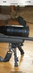

^…. It would be harder to clean grime or dry moisture out of a 12:00 flute, if a scope bell was right over it.
Just an example of how some scopes ride barrels. That’s a generic picture, not mine, but I always worry about rust forming in them.
:)) ok, ok, y’all win. If there’s a flute directly under a low mounted scope, a q-tip will probably still fit in there, if you have to dry it out. But I do have one, blued carbon steel, with really deep flutes that a q-tip definitely wouldn’t dry out with a low scope.
