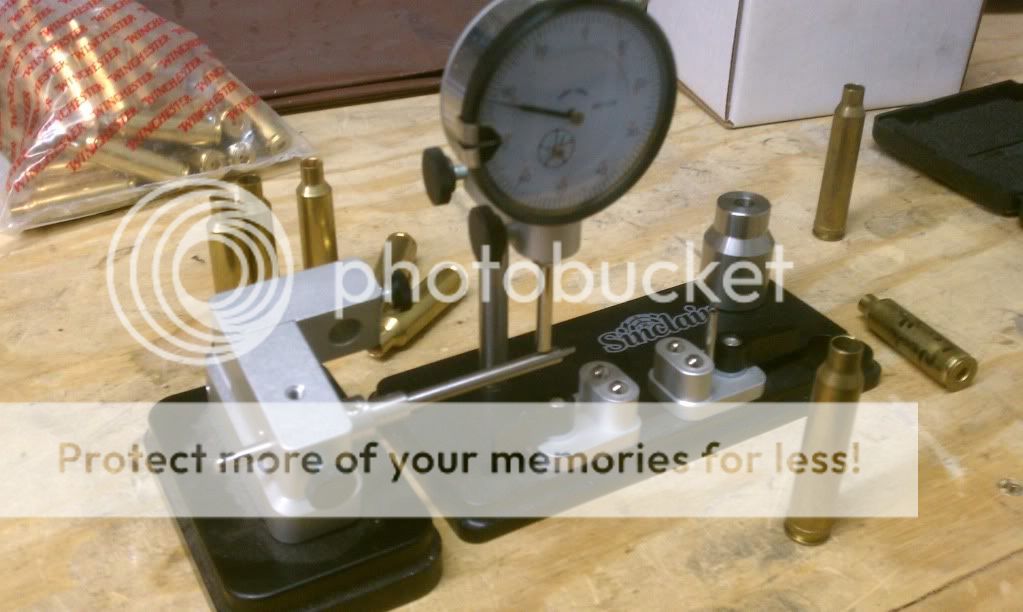

Until recently I have always just visually inspected the flash holes of new brass to make sure they were in the center. However, when neck sorting some new 300WSM brass to neck down, I tried measuring what I call "flash hole runout" by spinning cases on the neck thickness variation guage, but taking a measurement at the case web using both the neck sorter and the sinclair runout guage in tandem. Cases are completely unsupported by the case runout guage, I am essentially just using it as a dial stand. Not a perfect system, but it is stable and it gives real measurements.

The better brass (Lapua, Norma) gave very low measurements (0.001-0.002) pretty consistently while the Win brass gave readings all over the place (0.005-0.015) on just a small number of pieces (a couple even up to 0.020). What this tells me is that either the flash holes are oblong (not likely since the Sinclair spindle fits each flash hole almost perfectly, or the the flash holes can have tremendous variation as to their location relative to the center of the primer pocket. Measuring this runout tells you if the flash holes are centered in the primer pocket.
