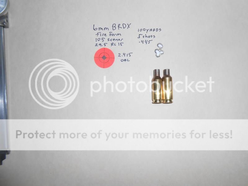

first try forming BRDX brass
loaded 5 rounds 29.5 RL 15 105 Scenar jammed hard enough that it is hard to close the bolt,,around .030 jam,,new virgin Labua 6BR brass straight out the box,,WW WSR primers,,
brand new Krieger .236 8 twist barrel on Stiller Tac 30 action,,cleaned barrel shot 2 rounds and cleaned and shot 3 rounds,,all 5 pieces of brass came out looking very good to me but I have never done this before,,

my calipers are out of whack,,dug my mics out and new brass is around 1.550,,formed BRDX is around 1.545 ,,trimmed all to 1.542 and turned necks just enough to get them all the same,,a couple here and there only cleaned up on one side,,
