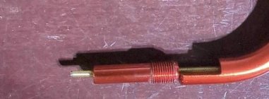

The guns owner got the same 1.822” CBTO today with their tools. We both were using the curved version of the tool but she noticed the bullet bottomed out in the short BR case against the end of the threaded portion of the curved tool head. Even when the cable was pulled all the way back the bullet could not get any shorter CBTO than 1.820” when it hit the tip on the threaded portion inside the case.
I can see about 0.100” of that tip coming off of that tool tomorrow.
These long bearing surface 6mm combined with the short 6 BR case bottomed out even when the cable was fully retracted.
Update to the Curved Tool Saga - I have used he curved tool for years in gas guns and bolt guns and have been able to get reproducible numbers with my technique for measuring the CBTO for touching the rifling.
I purchased a straight tool as I am shooting more bolt rifles than Gas guns these days. I had set the touch depth for a .308 Palma chambered rifle using the curved too a while back and was using that number and found a sweet spot at 0.010" under touch. I went to load up a bunch of 155.5's for full-bore and wanted to see if the throat had eroded appreciably with the few hundred rounds I had shot in that rifle since I measured it. I pulled out the straight tool and the same modified case, bullet, and comparator insert I had used with the curved tool. Same caliper too. I had previously determined touch point with the curved tool to be at 2.275" CBTO. With the same bullet and comparator insert, the straight tool was bottomed out and hard touch at 2.266". It seemed unlikely that the throat had shrunk...
The reading I got with the straight tool was about 0.009" less than the value I got using the curved tool. So I pulled out the curved tool and followed my normal procedure, same bullet, comparator insert, and modified case and caliper. My technique for using the curved tool involves holding pressure on the spring cable while I lock down the brass screw on the side. I re-measured with the curved tool and got 2.274" or pretty close to what I had previously determined.
I then tried to seat the bullet long with the cable locked , push the tool into the chamber and hold the cable and loosen the screw then push the case into the chamber fully and tighten the cable. Same 2.275" reading. On the last try - I suspected the pressure on the cable may be affecting the reading so I pushed the tool into the chamber, lightly pushed the cable and then released it while I tightened the set screw and.... 2.262" CBTO...
My practice of keeping tension on the cable while tightening the screw was compressing or kinking the cable enough that it would push the bullet out the extra 0.010" or so after the screw was tight and the case removed from the chamber.
The good news is I do not hang out near touch with most of me seating depths being well off of that number. But with this 155 load... my sweet spot was actually at touch. No engraving on the bullet and the bolt closes easily. I may strip the bolt and do the wheeler method to get a further comparison but the curved tool is for gas guns only now and my technique for using it will not include pressing on the cable while tightening the screw.
