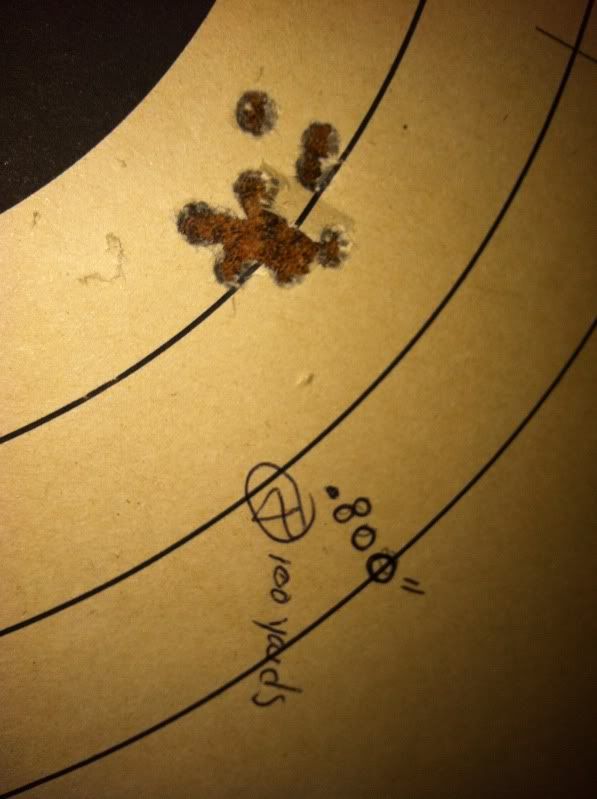

My first time out with the new 6 BR, from what i have read, 30g Varget and 80g Berger fb was one of the best loads, but ended up with over an inch pattern at 100 yards. Then i tried a string of 10 107g SMK bullets, seated at the lans with 29.5g Varget and ended up with an .800 spread. The 107's were smaller than the 80's in my 1-8 twist, but considering there is a man with my same rifle who shot a .2100 @ 100 yards at the last match, i have a lot of work to do.
Any Suggestions? Anyone?

practice -practice-practice- ...keep shootin and adjusting the powder charge and seating depth etc.....your on your way....Roger
"At the lands" is NO-MANS-LAND which will leave some of your bullets a little bit in the lands and others a little out (unless the bullets are extremely consistent base to ogive). That's a recipe for split groups...
Try the 107s .010" in the lands (you should see rifling marks), or .020" out of the lands, and report back.
I'd also buy a box of Bergers or Scenar 105s. Those bullets have always shot better in my gun than the 107gr SMKs.
Re the 80s -- Yes they are very accurate, but our accuracy load in 30.0+ grains of Vihtavuori N135 NOT VARGET. Varget is tool slow for these bullets, IMHO. Try N135, H322, or H4895.

the 80 gr Berger load on this site for 6mmbr was a winner in my savage LRPV 1-8 tw from the 1st shot..in fact i won 1 of 5 rounds in a club shoot last mo..2nd best for 2..and out of it for 2 ( me ). one piece of advice would be to do only one change at a time..don't easter egg it..you'll never know what worked on didn't.try the 80gr Berger varget load using exactly what is called for.seat one diameter deep ( .243 ) and try 4 or 5 5 round groups..if your savage is anything like mine they should shoot..
I have a 13.5 twist on my 6mm BR, for me the VihtaVuori N-135 works best, 33.5 gr and the 68 gr FB Berger match bullet, if I shoot groups larger than .300 then I'm doing something wrong... The load and the gun keeps below .300 and usually close to .200 for 5 shot groups.
For any 6mm BR the groups should never be bigger than .400 at 100m, if they are then something is not like it should be.. Load, bullet, shooter..?
Since no one out there is going to say it, I will....I have never, EVER, found a load that was best in my gun(s) without doing extensive load testing. Sometimes the groups got better, and sometimes the groups got HUGELY BETTER, but they always get better. Trying loads that you "read about" is not load development!! It is a shortcut that most likely will never work.
You want a shortcut.....do a round robbin ladder test. That will get you into the ball park. I shoot one on the way up and one on the way down..one min apart to keep the temps stable, and go from there.

the 107 SMK's can vary quite a bit in ogive length. The recommendation of a .010 jam will keep all of the *unsorted* bullets in the lands. If you try to do a .002 jam, you will still have bullets with a jump (because the ogive length is inconsistent).
.010 jam or .010+ jump are good starting points.
If you sort your bullets by ogive length, then you can really start tuning with seating depth down to .002 jam or .003 jump (as examples). If you don't want to sort, then I'd stay well away from the lands (jump), or well into the lands (jam). Otherwise you'll get random pressure changes. For example, you are jumping .002", then you chamber a round with a longer ogive that is now .003 jam... pressure will increase, and it might end up as a flier at the target!
