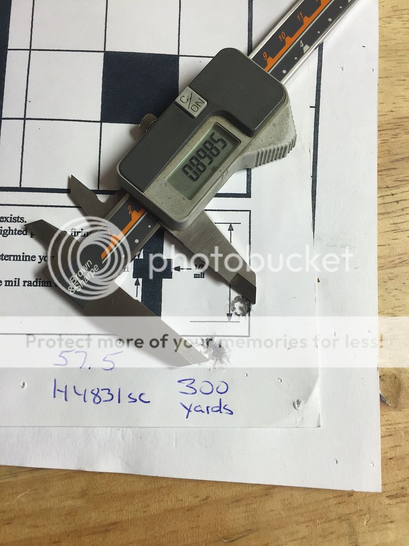

Loads 56.0-57.0 grains shot in the ball park of 2.5" and were three shot test groups. Then when I got to the 57.5 grain charge the group shrunk down to a nice .8985 outside to outside measurement with 2 nearly in one hole.

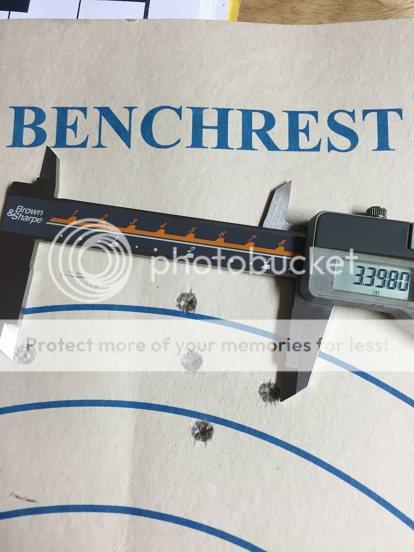

This evening I went back to the range and setup out to 500 yards with charges of 57.5, 57.8 and 58.1 grains. I also loaded up another batch of fire form loads and got zeroed in at 500 yards. After I got sighted in I decided to put the magneto speed on the rifle and get a velocity of my load then I put 5 rounds on paper right before the time expired for the range to go cold. So I ride down and looked at the target which had verticle and one flyer out to the left, this group measures 3.398 this was the 57.5 grain charge. So as the range went hot I decided to just leave the magneto speed on the rifle and shoot the next two groups with it to go ahead and gather my chronograph info. After I shot those groups I had five more rounds left of the 57.5 grain load so I thought ok I'll remove the magneto speed and put the muzzle brake on and see what it does.

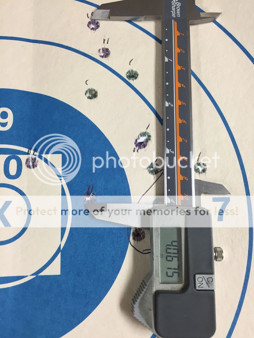

Below are the pics of today's resuots starting with the 57.5 grain load at 300 yards.
Here's the first load using the magneto speed this is at 500 yards and the 57.5 grain load as well.

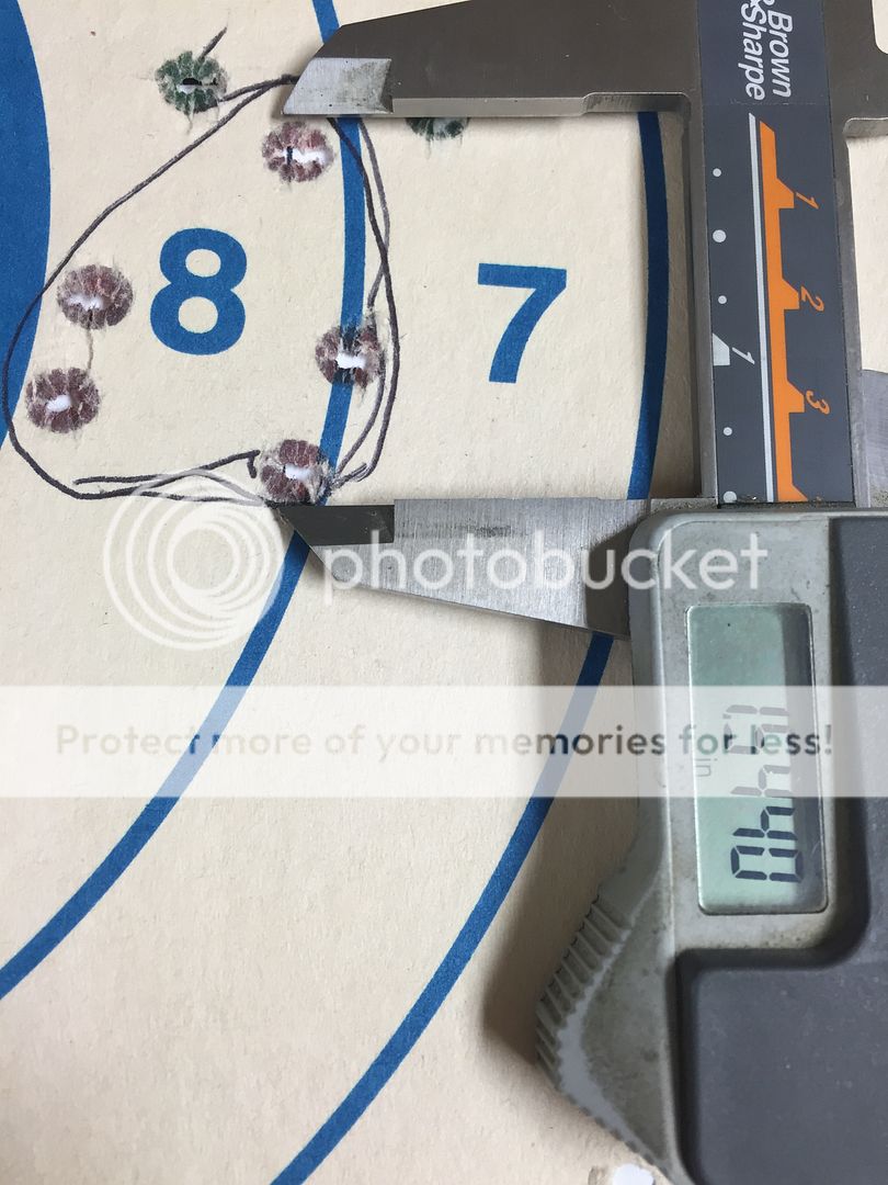

Here's the 57.8 grain charge.

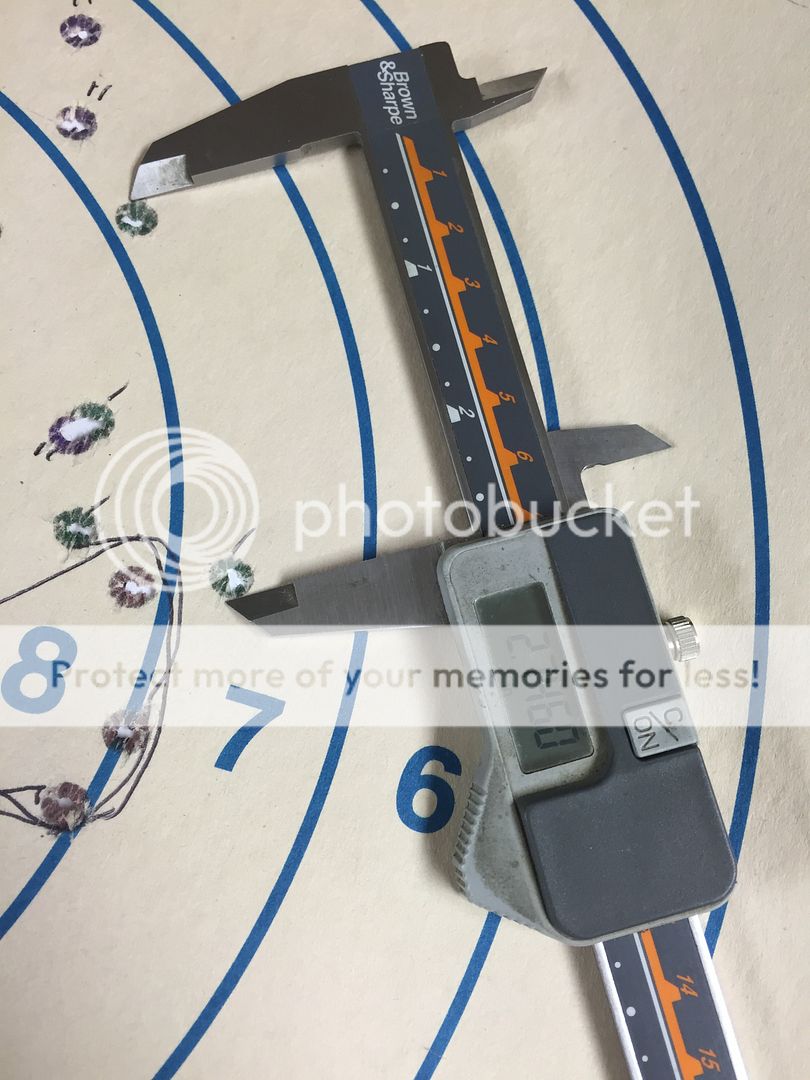

Now here's the 58.1 grain charge
Everything shot with the magneto speed attached had verticle to it as you can see in the photos all shots were five shots even if picture may not show it as I was trying to just show the group size with charge weights.
Now here is the big kicker this next group is back to the 57.5 grain charge with out the magneto speed and the muzzle brake back on.
I'm impressed with the group but not my velocity, and the numbers.
