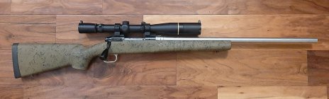

I just wanted to share about my first build. I wanted an accurate hunting rifle to hunt here in Oregon for mule deer and elk. So, when I saw a lightly used Savage compatible Shilen Select Match barrel offered here, plus a used HS Precision stock, I purchased those. Then got a matching Savage 10 short action, purchased that.
Purchased a precision ground recoil lug and barrel nut from NSS, plus their barrel vice, barrel nut wrench, and go/no-go set as well.
Got a Leupold VX-III 6.5-20-40m scope, Burris bases and Warne rings. This is intended to be an accurate hunting gun. Just got the barrel back from the Gunsmith, I had it bead blasted to take off the shine. I took him the whole rifle, thinking he might have input on other parts of the build. When he handed me the rifle, he had installed the barrel, head-spaced it in the action, and it was ready to shoot! Well, I guess I didn't need that barrel vice, wrench and gauges right now after all...
Got a Leupold VX=III 6.5-20-40m scope, Burris bases and Warne rings. This is intended to be an accurate hunting gun. Just got the barrel back from the Gunsmith, I had it bead blasted to take off the shine. I took him the whole rifle, thinking he might have input on other parts of the build. When he handed me the rifle, he had installed the barrel, head-spaced it in the action, and it was ready to shoot! Well, I guess I didn't need that barrel vice, wrench and gauges right now after all...

good looking build!

Nothin beats the feeling of a new gun! I love the 7-08, there is so much to play with there. And it'll give the elk hell. That 9 twist is good I suppose, and those 154's will for sure put em down. I would for sure work on the load a bit more though, I'd be surprised if you can get it to shoot significantly better than the groups shown. Also, curious about your scope mounting. Why so far back?

The scope is set where it's right for eye relief for me. It gives me the full view at 20x power when standing or sitting, it does look odd in the photo.
