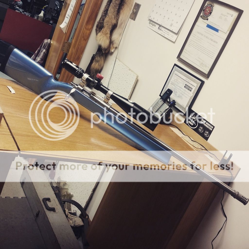

So 15 months and a hunk of change later, I finally have it in my hands. BAT action, kreiger barrel 1:8 twist 28" with tunable brake, jewel 2 ounce trigger with the roller thing he suggested - sorry I'm not full speed on terminology yet, nighforce competition 2014 with I believe kelbly rings - I regret not asking for full build info. I had some head space issues first trip up, and got no more than 2 shots out of 5 rounds per charge, one set of 5 had all 5 ftf. So I switched to lighter primers as advised and bingo. So, first real group, at 200 yards shot ok I thought, measuring .533" using RL 17 and berger 108. So far I'm happy and cant wait to see that group tighten up! Oh and I got a model 1200 rest from TSI to try out. The stock color is the paint code off my s10, haven't snapped a pic of the two together yet haha.

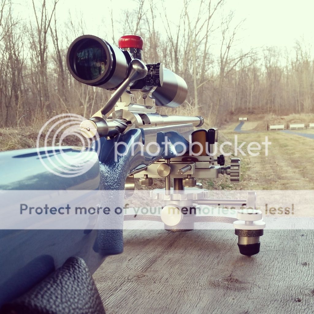

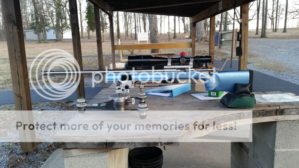

Any reason you use your front rest backwards?
If you spin it around you can use the stop which is pretty handy.
Re: finally got my rifle, 6x47 lapua
the top itself flips. and i had it the other way prior to this pic. someone told me i had it backwards but apparently it wasn't. If i turn it the other the way then i'd have to reach out around to tighten the clamp for main elevation adjustment. flipping the top back to how i had it would allow me to use the stop, so yes that part is backwards. i should have left it go like i had it when i first installed the top!

Simple....when making fine elevation adjustments you simply turn the knob on the rear leg of the rest. It seems that to make proper adjustments you need to turn BOTH the left and right leg knobs.

The rest is positioned backwards in the photo. The "Y" goes to the front, the single leg to the back, closer to the shooter. Fine elevation is done from the single screw at the rear. Otherwise you get cant. The large adjustment feature on this rest appears a bit awkward, located at the front, but that is a design issue, not a use issue.
A quick review of bench technique by watching the PPC guys shoot on youtube will help get you through rest application and set up. That will improve your groups. NICE rifle, BTW

OK...quick lesson. You technically have Two ELEVATION ADJUSTMENTS. You also have a "gun stop" which you are not using.
Next time you are at the range, turn the rest around so that the single leg is in the rear. Adjust your elevation with the wheel and lock knob as you usually do. Now, get down and look through your scope and turn the knob on the back of the rear leg (the one that you use to "level" the rest on the bench) back and forth. That is your FINE ELEVATION ADJUSTMENT.
The other thing is the gun stop. That verticle rod with the black cap on it that is now out front of your front bag (because you turned your rest around)...that is the "STOP". Raise that up to a point where it is just short of touching your BBL. Now when you slide your gun ahead, you slide it forward till the stock hits the rod.....every shot.....over and over. It is a repeatabilaty thing....every thing the same ....every shot. It also looks like yours is adjustable front to back!! That is great...you can fine tune where on the stock you want the gun to sit on the bag.
Unless they have a joy stick type front rest, every BR shooter that I know uses the rear leg height adjustment as the fine elevation adjustment while shooting a match. I suppose that there are a few bag squeezers" out there, but they are very few. Give this a try and let us know how it works out. I am convinced that you will shoot smaller groups...maybe MUCH smaller. Your gun handling will improve and your speed will increase....both CRITICAL for shooting small!!!!

All of that noted! Thank you I'll get to try it all out this weekend. I didn't think of the rear foot as the fine elevation. I did flip the top around and was sliding the end of the stock up against the stop every time.
