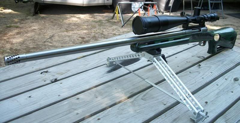

Flex-Bipod works for me.
............. and for me. (Do a search on the Bulletin and you'll see Monte Milanuk's write-up as to why this design works so well.)
This is not a feet-track-back-on-the-ground type. It involves a certain degree of loading, the exact amount determining the muzzle elevation. It works brilliantly on the UK's grass turf firing points. For hard, gravel etc firing points a piece of carpet or doormat anchors the feet just fine.
Because of the ease with which fine elevation changes are made using body pressure on the buttplate, there is no need to squeeze the back bag in the aim. I switched to a hard packed heavy sand filled Edgewood bag as used by BR and F/O shooters and its greater stability and consistency helps reduce long-range elevations.
