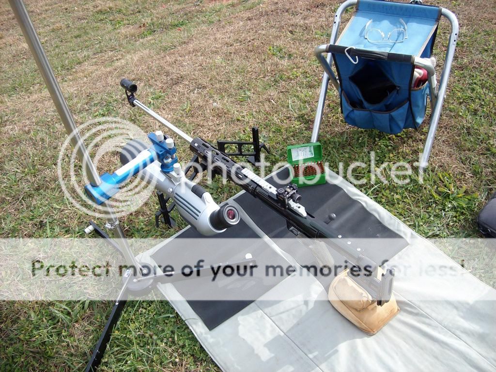

Well, no one showed up but I went ahead and tried it anyway. It has been years since I have shot any F/TR. So here is the rig. One thing, it was a lil wobblely, due to the fact that this one forgot to back bore the hole for the adaptor (the stud actually) to fit properly, so I had to makeshift a spacer for it to tighten up. It was half donkeyed of a try, but I made due with it. So I would have to load it up like a Harris, over all it felt at least a lil solid. Recoil was consistant, though the front sight came down just a lil to the left, leaving only the left side of the target frame in the front iris, it was consistant with each shot. I can not say that I had too much variation in that.

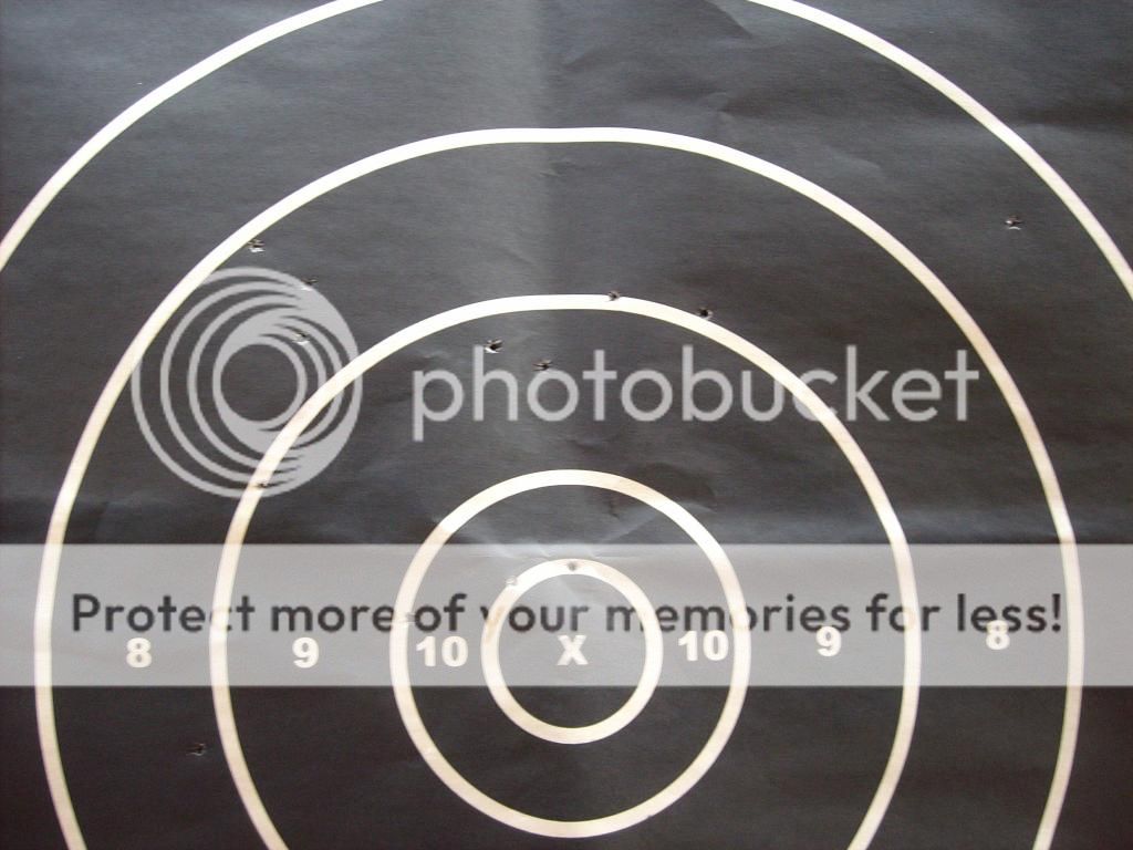

So I took a sighter, not having a good zero on the rifle and it was up near the top of the target. (After each shot during sighters, I would shoot one and then drive down to the pits to check the target) So I got back to the 600 yard line and made an adjustment on the sights, both front and rear. Shot another sighter, this one was an 8 at 8:30. So then I came up 3/4 and right one minute. Each shot was executed when I could not feel any wind blowing on me or around me, next sighter was a 12 o'clock X! So I go back to the 600 yard line again.. this time, I shoot a string. It was difficult to say the least, without the flags and no mirage to go by. There were were times I was just laying there, waiting for the wind to not swirl or blow me and my equipment away. Most times it was coming in at 3:30 to 5 o'clock, then just gust up into your face, blowing crap all over the place it seemed. Considering the conditions and that it has been a long time. I feel that I didn't do to bad, though there was one mistake that I did realize I had made, but only after reflecting on it after seeing the target. When I was laying there waiting for the wind to be friendly with me.. (ha!), I made the mistake of eyeing the sights instead of looking at something else while waiting for the what appeared to be good conditions to shoot in. It was a battle. I am not sure if laying on the sights cause any of my elevation, but I do know that it could have been a part of it. Though I bet the wind was mostly the criminal.

Well I went out and played some more today, the wind was coming in from the right. Once I get it zero'd up, I shot a string of 20. The first sighters were at 9 o'clock about 3.5 moa out. Then I shot 3 more one right after the other, they are at 9:30 and 10 o'clock in the 9 ring. From there out, I made the last wind correction and then shot the string.. ended up shooting a 193-7X. Not too bad for shooting blind and my second time out with this set up. The rifle was the same as before, Eliseo stock, Remington action semi-trued, X-Treme trigger, Rock Creek 7.2 twist 30 inch barrel. This barrel has about 4200 rounds on it and it still is shooting pretty dang good. The load is a Hornady 75 Amax with 24.0 grs of H4895 powder, Lapua brass that has about 12 firings on it and Tula primers. If it weren't for the Tula primers, I would not be using this brass anymore!

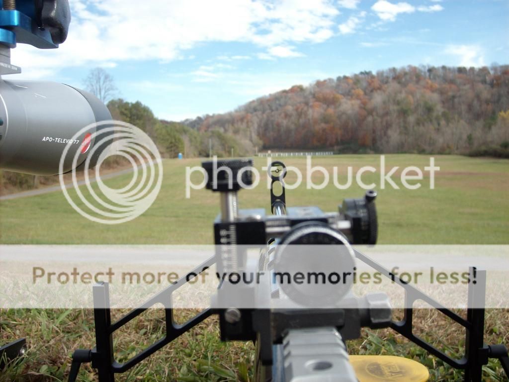

I use a Centra 30mm front sight, it is set at 4.5mm on the iris it's self with a .5 diopter lens. The rear is a Warner #2 long range rear sight. It has a total moa of 72 minutes from top to bottom and left to right if I remember right. Once I started the string for score, I didn't make any adjustments to the rear sight at all, just tried to shoot the conditions. It is sometimes very hard to see a half minute's difference in the wind or mirage. As for the front sight, I didn't make any changes to it as to compared to shooting sling, it was at the same setting, one line of white around the bull.
