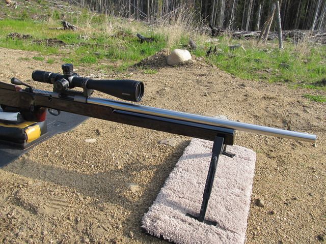

My new FTR rig... I am fully into the long forend camp. The difference and improvement in both tracking and hop has to be used to believe. That is a 30" barrel for reference.
Balance as pictured is just in front of the receiver as it should be.
As an evolution of this, I designed the MPOD to be basic, simple and very light. Call it rear steer if you will... fine elevation adjustment is done by sliding the stock for and aft in the bag... the bottom of the buttstock has a taper. I saved a ton of weight and complexity... do not need to break position to adjust and it works very well.
Best part, I don't need to fiddle and fight with the bipod through a relay. Just push back into center and send another shot. It doesn't change its setting.

Same concept at top fuel Dragsters and their very long nose. It is all about controlling "weight" transfer or in our case, movement due to recoil. Just having a stock with a long forend doesn't necessarily mean you will solve all ills. Alot went into the set up of my stock and a number of dimensions are not conventional. As is the style and geometry of my bipod.
The physics doesn't lie on the affect of putting a bipod further away from the receiver. It is the HOW that changes the story and some set ups may show negative results.
