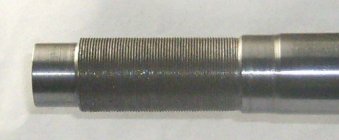

Well here goes.....Thread is about 1-7/8th" in length. Threads look a little
ratty but, that's the dark molydisulfide powder I brushed on. No grease.
Clearance was checked for the new bore in relationship to the tungsten
pockets. Lots of room. I bored to the beginning of the original thread and
left it .0015 undersize. I did not knock off the tops of the thread and left
them sharp. This way, as I thread it on, it will actually cut into the new bore
ever so slightly to make for that perfect fit. It fits so good that the original
3 screws used for tension don't need much turning in......The muzzle itself
sticks out .160" with tuner screwed in tight. Plenty of of room to work with
along with extra material for re-crowning when needed. I do touch up my
barrels a few times during their life. I did also add an o-ring at the front.
Done !! It's just another of my one off exercises. Still waitng on a point up
die for a press I built, and we'll get this out to the range.....Stay tuned.
