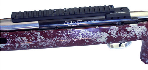

I'm looking for ideas where to find/buy an extended scope rail for a savage Palma rifle action. Planning on doing both irons and scope matches with it. Ideally, I like the rail to extend out in front of the action 2-3 inches and 20M0A. Moving the scope more fwd helps with eye relief in prone position. EGW makes one but a 0 angle so getting to 1000yd elevation will be kind of hard or impossible.

Someone makes blank Pic rails if I remember right they were 12" or maybe 16', just drill our own holes. But can't remember whom, maybe EGW? Or check Brownell's to see what they have.
Word of warning with 20 moa scope rail and iron sights. You can will not have a round rear aperture as you are looking through it at a slight angle. You will need 30 MOA to get to 1000 with most cartridges. Most 30mm scopes will have that but the Burris Signature rings are a real good alternative to the 20 moa rail if you want to slap an iron sight on the pic rail.
If you can find somebody to machine you a 20moa rail be the easiest way . So is you savage a round or a flatback action. As savage has both styles of action and you will need to know which action you have before you can get a rail due to having 1 radius different to the other . Make plenty of rails ever year but unfortunate I'm not in the US.
Decided on the 0 MOA scope rail EGW offered using the Burris rings with offsets to get the angle needed. Thank all of you for your ideas.
