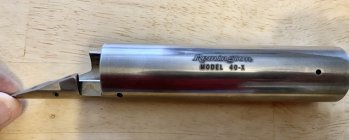

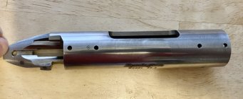

I picked up a New Remington 40X action, no bolt. My dilemma is that I have never seen one like this. It is marked Remington 40X on the right side where the ejection port would normally be and in what I believe is the laser script. It is a left port, right bolt. The serial is CS 1XX2. It does have the bolt guide in it and I think it is stainless. It is also a straight cylinder without the lower and flat rear section that most Remington's have for the rear scope base. It is polished. Any idea were to get a bolt for it. Not sure what section to post this in.
Any help would be appreciated,
Tom
Thanks for the reply, It would need a left ejection bolt unless a right bolt could be converted.
Oddities, in addition:
I don’t see a the circle R for “Registered” they use, by the name, on 40-X’s. I have seen plenty of 700’s without it but I don’t recall seeing any 40-X’s without it.
A Four Digit serial number would seem to predate both laser engraving and their much later use of stainless steel, by decades.
Sandwiched between roll mark usage there was some laser engraving but it didn’t look like that.
“Remington” is single line lettering on 40-X’s I have seen.
A two letter prefix and a four digit serial number that starts in “1” might be a person’s initials and year of birth or month and day.
Of course “CS” could also be custom shop internal designations for nonsalable and test actions that they nevertheless had to serialize and book, but never planned to sell.
Unless that’s a plugged screw hole in the rear, the spacing for a base in the rear is far off.
That is probably a very custom shop built for the Amy MTU.
I had in my hands at one time. A 40X that was built on a long action. but used a short bolt. the longer tenion was used for more threads. Had a silver soldiered front and rear recoil lugs over the action screw holes
What would be a fair price to ask for it if I decided to move it. I really am at a loss for this one. The top scope holes looks like a Stiller action.
Any idea where to get a bolt other than PTG or have a bolt converted if possible. If the bolt could be figured out, I could do a 6ppc which I would think would be cool.
It appears that one of the rear screw holes for the standard 700's 6-48 thread/.605" rear base screw spacing has been plugged and the receiver modified to use the .860 spacing bases (standard for the 700 front). All the screw holes are 8's...likely 8-40's. What's strange is that the rear base c-c would have ever been made .605"...since the receiver bridge on a standard 700/40X isn't full diameter like the front is.
Pretty cool 40X variant. Put short 700 bolt in it and see what it measures. If that looks ok, stick a trigger in it and see how it works. I'd measure the receiver raceway diameter before ordering a replacement bolt. If that all checks out, Mack Bros. makes excellent replacement 700 bolts.
Good shootin' :) -Al
