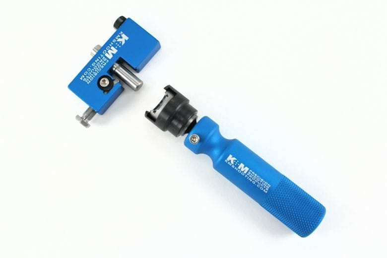

If you dont have the proper size expander in a die set, K&M may be the cheapest alternative. A V1 press adaptor & a 270 tapered expander will cost you under $30... + shipping.
