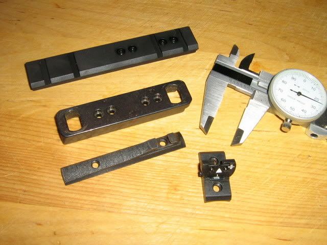

The reason i ask is they dont make a leupold style base for the 'rifle' but they do for the pistol. I was hopeing that i could use on eof those.
Ollie, sorry for the bad info yesterday, I was thing about my XP100. I checked on EGW web suite today and they now manufacture both T/C and Encore one piece Picatinny bases and they are available with 0moa or 20moa for 29.95, product #42/50. Midway also sells a Encore Weaver Grand Slam 1 piece steel base #782-351 for 20.49. Hope this is helpful.
RJ
The base is the same for the rifle and pistol. However I do not like the length of the Leupold one piece base, it is too short, and does not allow for any scope movement in the rings.
I prefer the Warne system. It is a good solid system, and it is a good bit longer to allow adjustment for eye relief. If you need a set of the Warnes then let me know I have an extra set I would sell for a decent price. Tom.
The Encore and Contender have the same screw spacing on their mounts but the the arc of the mating face are different as the Encore is a larger diameter
Same frame is used for pistol or rifle. Bases will fit. Just like the Contender frames. All that changes is the hardware and barrel length.
Might be an old thread but somehow the barrel wall thickness never got mentioned.
With the Encore:
Don't use a rifle mount base on a shot gun barrel!
The provided screws will exceed the depth of the tapped hole.
A special base is required for shotgun barrels with the Encore
or at least the shortening of the provided screws is suggested
