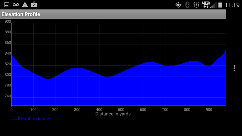

I have not lost one in my last several matches that I did not know why! (Every time i have lost a vertical point, i have missed a headwind or tailwind call) Do a google search of the altitude and plot it for the full range. Head and tail winds at Oak ridge WILL have a vertical component as well due to the terrain.
I video taped most of the match this weekend. Yet to watch it but I will just about put money on it when almost the whole line had a vertical loss, that the flags will show a head or tail wind somewhere on the range.
Another thing you see at Oak Ridge. Sling on the left, F on the middle to right side. Slight differences in the range there too.
Oak Ridge elevation profile.
Sir I don't want to get into an argument but I have shot on the right side and there is very little different there as to the left. If you talk to Thomas or Phil Crow (Reigning Wimbleton and Leech Cup champs) you won't see them loose high 8's due to wind. Also I have been down there when Danny Biggs and other F-Class shooters have shot some very nice scores. While the elevation profile does look impressive it is not as sever as you think because the bullets are flying above a lot of the potential turbulence. I too have lost elevation shots there which I assumed was the wind, but like I said looking back on it it wasn't the wind it was due to my follow through. When I get home I will run this range with the Navier Stokes equation and you will see it is not what you think it would be, will post later this evening.

Ok first I will say I was thinking 8 ring on the regular LR target not F-Class. But anyways lets take a look at the range. There isn't Lidar data of Oak Ridge so using the best elevation data I got.
Here is Oak Ridge along with some of the surounding area. Where you see the point saying not defined is roughly around point 10 on the 1k berm
The maroon line is roughly tracing the path to the impact berm and stops on the back side of the butts. You will see the swirling that comes in off the mountain in the back that causes all the wierdness on the 300 and 200yd flags.
Here is the look at the cross section of the wind
Please not the smoothness and lack of any vertical wind. At the target area you do get a little swirling but it isn't coming off the 900yd berm.
Just to check lets do the same thing off the ridges to the south
Now we take a cross section
Notice the more severe uplifts and down drafts that occur well beyond the target carriers.
This was simulated with a 10m/s wind (22.13mph) with less wind you will get less effect. While the elevation plot is impressive you are only talking 40feet in change. If we were shooting over one of the ridges then yes we may notice something. Hope this helps a little.
