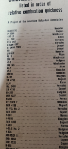

I got a can of this fantastic new DuPont pistol powder today. I haven’t seen it on a shelf anywhere, so I assume it’s brand new. :D I also discovered that the powder companies are working hard to keep the prices down. They only put 8 ounces in the can, and it was priced at a very attractive $1.45. I’ll do a ladder test with my Springfield 9mm and get back to you. :p:p161997D7-8EF7-4FEE-8363-0CEC8079A2FF.jpeg

Loading's usually show it just after Bullseye, so it's on the fast side.
