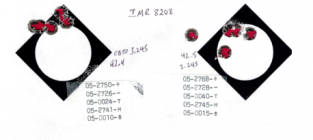

Bill that's what I had been told and believed, but my Oehler 35 refuted that completely. The pictures below show 3 charges (42.4, 42.5 and 42.6) with a CBTO (Case Base To Ogive) of 3.245 and 3.250. As you can see the pressure drops as the CBTO gets longer. And that continues for several more iterations. By the way the bottom 2 target show a flyer, well that's my fault, I'm a bad shot and need lots of practice.

Joe R, when you jam the bullet it will create more pressure. Maybe you are simply in the lands and not jamming. If jamming did not increase pressure, you must have light neck tension that allowed the bullet to "soft seat".

Erik you are correct, when I jammed my bullet hard into the lands I did get a velocity jump of about 50 fps, but as soon as I backed off that even by .003 the rate of velocity drop decreased to about 5 fps for each decrease of .003 in CBTO length. That rate of decrease was constant for several iterations then the velocity started climbing again. The only reason I can think of is that the decrease in volume of the case because the bullet was taking up more space causing velocity to increase again. Maybe someone here can think of other reasons and illuminate me.
