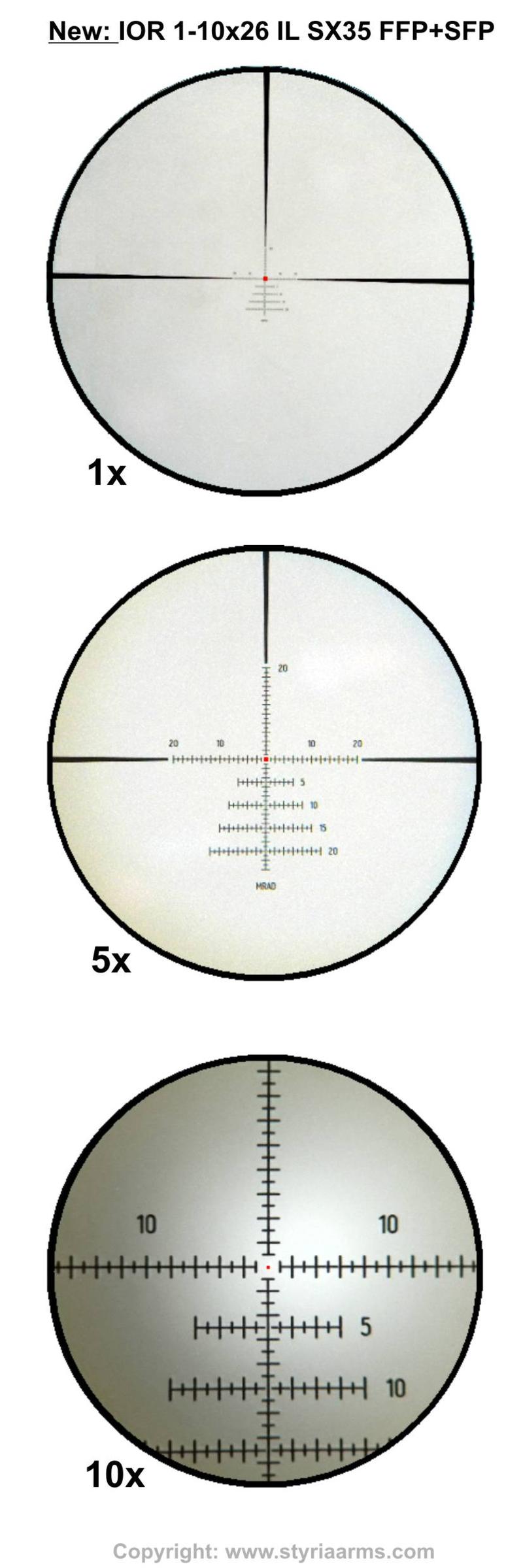

What I was thinking- what if there was a FFP scope that had a duel reticule, or reticule within a reticule? Meaning at the lower powers the cross hairs look solid but as you increase power the reticule magnifies as usual, but instead of just thickening it magnifies and exposes that it's actually 3 lines. The 2 outer lines that combine to appear solid at lower power and a fine line between that you can only see at the higher powers?

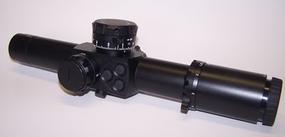

IOR, a highend scopemake in europe, make a 10x zoom scope with dual reticle.
The Shepherd scopes use one reticle in each focal plane. The distance judging reticle is in the FFP while the aiming reticle is in the SFP. http://www.shepherdscopes.com/dual.asp .
