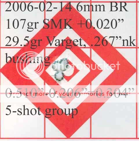

Here are a couple pics from a 10FP, trued & timed by SSS w/ an SSS barrel,27" 6mm BR, .272 no-turn neck, 1-8" tw). The 'bigger' one is a little more 'typical', but there were plenty of ones like the small one that came out of that tube as well. I bought it as a take-off from someone who 'just had too many 6mm-whatevers in the safe'. ;)

Ever measured the diameter of a single bullet hole in a piece of target paper?
The thin stuff,like those Outers/Redfield targets) tends to stretch quite a bit as the bullet goes through. The holes are almost never the same as actual caliber size. Also, its very often not possible to get a good read on the edge of the hole. This is especially apparent if you happen to scan a target into special software like On Target - the caliber 'holes' you put over the bullet holes in the image are almost always noticeably bigger than the physical holes in the paper.
The thicker paper,almost card stock) you see used in formal targets used for sanctioned competitions leaves a relatively crisp edged hole, which also happens to be closer to caliber size,but still not quite).
In the first group, if I took .395" - .243" = .152" then the group would be unrealistically small. Hence, I took the actual size of a single bullet hole,elsewhere on the paper) to find the real group size.
If a person wanted to get *really* picky about it, apparently the BR crowd has specialized tools for magnifying and measuring the group sizes.
