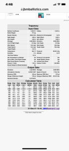

I am pretty new to ballistics and calculating drop charts. I was playing with one of my AR’s today. Shooting 77 SMK I was getting 2635 fps. I loaded that data in to JDM ballistics calculate and it spit out info below. Seem rite? Anyone recommend a different calculator? Thanks.

JBM is real good. I have used their data for years for matches and still do for some rifles. I would get rid of the inches in the column and if it's an MOA scope make them both MOA or the same for mils. You have the sight height good which is something people forget and usually leave at 1.5".
