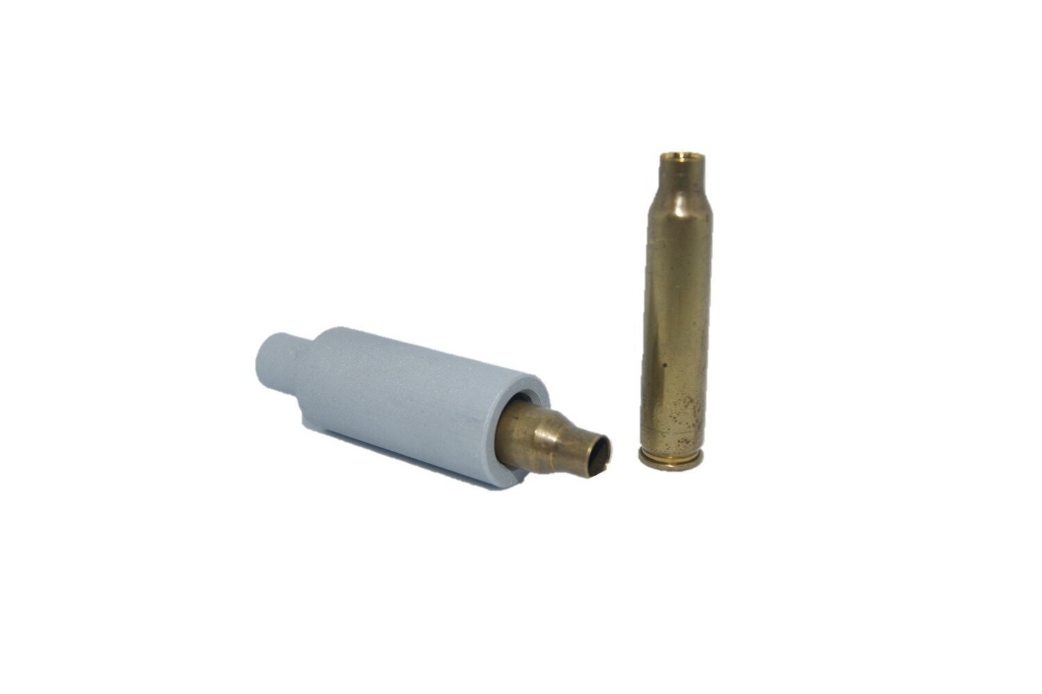

Is this what you're looking for?
Like a previous poster I used to use deep sockets until I bought an Annealeze, which I love. But... it won't do 50BMG so I bought a mandrel from Little Crow. Works great.
Yes thx. thats what I want!. I havent annealed in 5 yrs but did it today with the socket method. Worked fine but being arse retentive the socket wobble bugged me so willing to pay a few bucks for ones that spins straight!

thx. found out littel crow makes the perfect slip in inexpensive mandrels.
