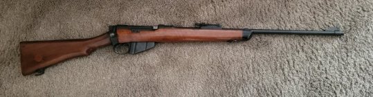

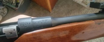

do you mind taking a phone pic of the receiver and posting it?
The rifle is at the smiths right now so don't have it here to take pics but these are a couple from earlier.
an idea,,,, get the two piece redfield mounts or bases from the 50s and 60s. they are on ebay. see how they match etc w the receiver. and go from there. you may end up not using the mounts but it will give you certainly in your decision. PS, that sporter job was well done. good looking rifle.

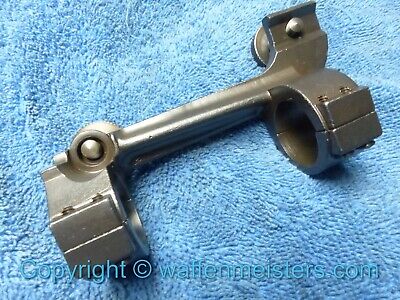

The S&K insta mount will allow you to mount a scout scope over the rear sight. No drilling or tapping necessary.
