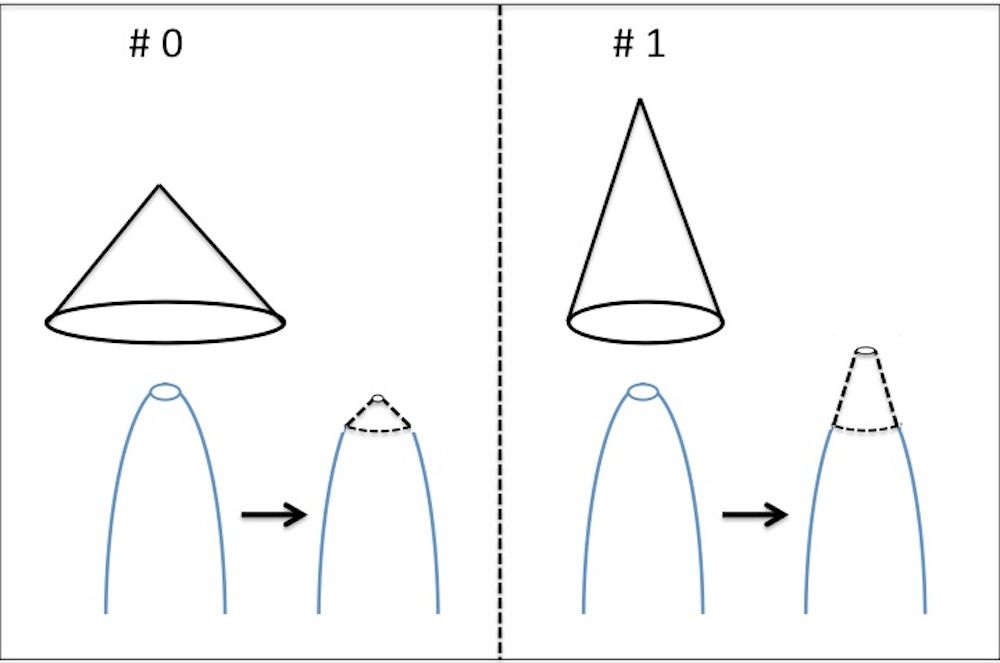

The less acute the angle, the longer the point must be in order to close the meplat by a specified amount. A shorter, fatter cone will result in closing the meplat faster than a long narrow one. This can make a difference as to how much one actually has to push the die insert down to close the meplat by 50-75%, thereby increasing the possibility of creating a bulge behind the point or causing other damage to the bullet ogive/nose/jacket (i.e. over-pointing). Although within reason there is probably not a "wrong" way to do it, any differences will be so small that it's unlikely you actually could shoot the difference. For that reason, why not simply use the recommended die insert and minimize the potential for causing a bulge or other damage to the front end of the bullet? You're not going to gain anything by using an insert designed for a longer skinnier bullet nose on a shorter, fatter bullet.
This is an exaggerated illustration of Whidden inserts #0 and #1. I have accidentally used insert #1 on Berger 185 Hybrids, for which #0 is recommended. I had to set the pointing die micrometer much lower when using the incorrect die insert to achieve the same amount of meplat closure, resulting in a much longer point on the bullet, and very likely, a much greater risk of nose damage. Having said that, I couldn't tell any difference in how the 185s shot when pointed with the wrong insert, although that may not always be the case if the nose actually becomes bulged or damaged in some way by overpointing. In my hands it is only necessary to close the meplat by 50-75% to receive ample benefits from the pointing process. In other words, less is usually more.
