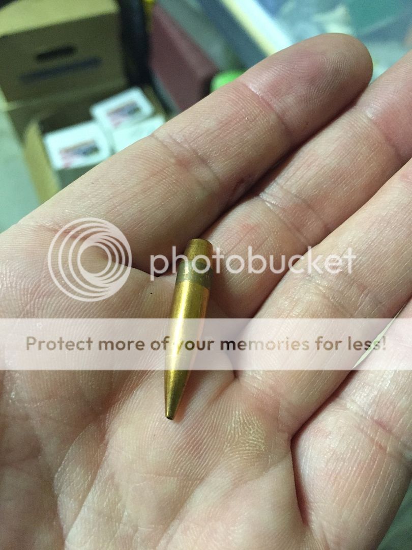

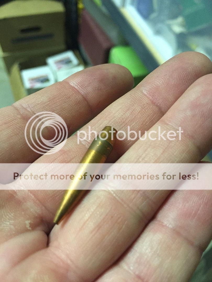

Heres a couple pics from some loads that were loaded for 2 weeks. Load ahead of time at your own peril is all i can say. And before anybody asks the necks were turned flawlessly and loaded with dry graphite lube and .003 neck tension. Corrosion starts the instant 2 differing metals come into contact. They were loaded with no seating tension differences but i seated some farther just for my own testing once i seen the damage and there was 20psi differences in pushing them .010 deeper before pulling
I dont doubt that. Most folks concerned with bullets sticking/leaving rounds loaded will have graphite, carbon (graphite residue) or both.
I ran really light neck tension on ammo for a rifle i used to have. One time i had loose bullets when i grabbed an old batch to go shoot. I could easily move the bullets by hand.
I dont know why this couldnt go the opposite way as well. Just be harder to tell.
